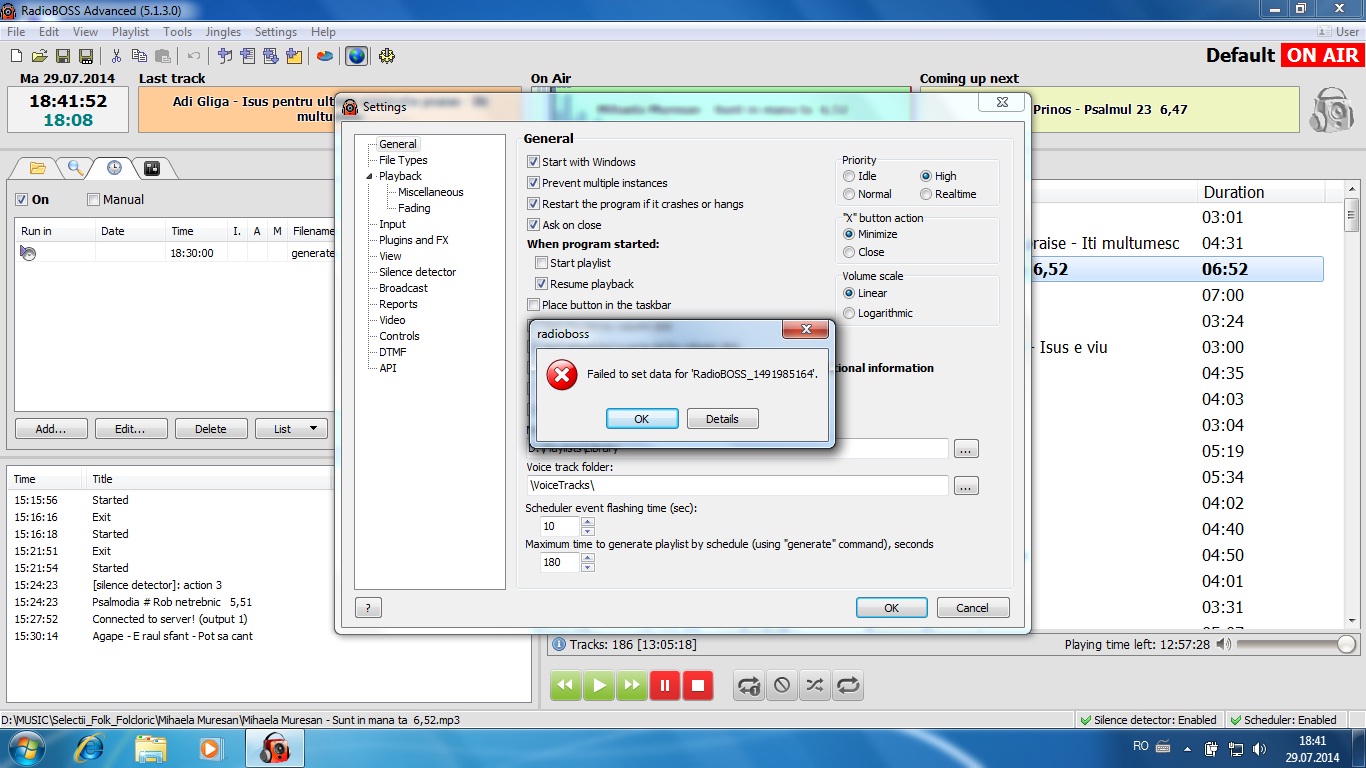

On the same machine RadioLogger and RadioBOSS crashed.
Also work RadioCaster too.

From the bugreport, it looks like something (an antivirus, likely) prevents write operations on the registry. Try disabling it or adjust its settings.

It will run without problem under User account. I'm still sure the problem is antivirus - it prevents writing to Autorun section of the registry (probably it thinks that it's virus activity), and RadioBOSS simply notified you of this error. This is not crash by the way - you can click OK in the error message box and continue working with RB safely.

I think there should be a setting to control this behavior. There's nothing we can do from RadioBOSS's side, as it's some external software blocks the registry.
