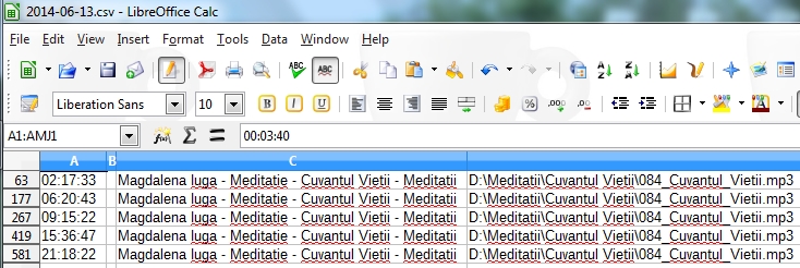

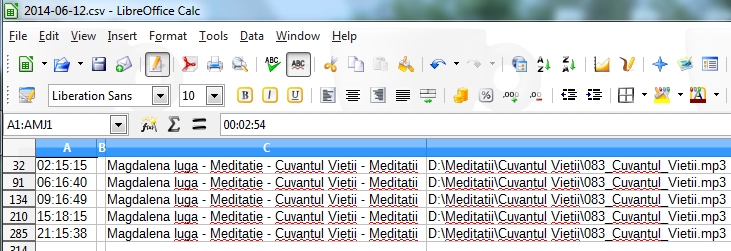

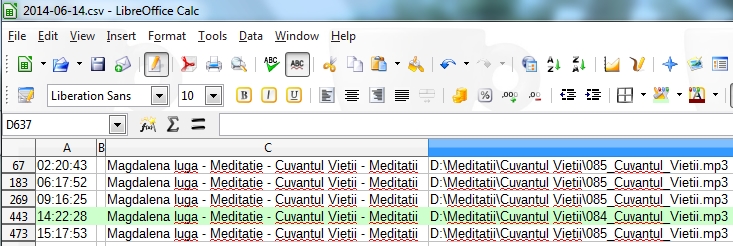

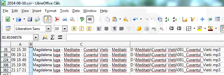

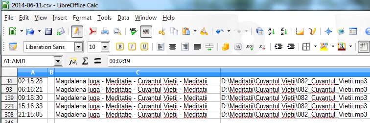

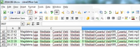

Dmitry, I checked Reports and I found that Rotations works, but something strange happened..
I started in 10.06.2014 with "Add Track List" wich load a playlist with five rotations per day.
Everything works fine.

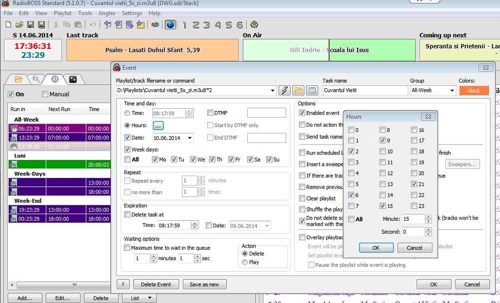

Today I checked Reports and I found another "Meditation Track" loaded today, BUT not generated by Scheduler. I really do not understand how that track was loaded. I generate music one time per week with "Remove previous schedule from the playlist","Clear playlist" and "Do not delete tracks..." checked.
Also, in add meditations Event I have "Do not delete tracks.." checked (see _0_Repeated Event.jpg image).
Please, make me to understand where from was loaded track from 14:22 (see image _5_14.06.2014.jpg).
Another issue: How to escape garbage tracks from a playlist? When (in what situations) to use the options from EVENT?
Another important issue. When I make some changes in Events in RadioBOSS memory remain the old features. Is there a way to refresh all Scheduler in RadioBOSS memory?
How does the source playlist (vietti_5x_zi.m3u8) looks like? Probably it's an error in the playlist.
About garbage tracks, it depends. A lot of people clean them at the top of every hour, e.g. an event which starts at 00 minute of an hour has the Clear playlist option.
Another important issue. When I make some changes in Events in RadioBOSS memory remain the old features. Is there a way to refresh all Scheduler in RadioBOSS memory?[/b]
Can you please give more details on this?
