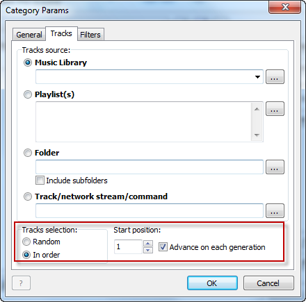

Another, more automatic way to do it:
1. create Playlist Generator Pro preset to select one track from a source (with "Advance position on each generation" option, see the image attached).
2. create scheduler event to generate and save the playlist (just generate and save, do not start):
run PlaylistGeneratorPro.exe -preset=MyPreset -out=C:\playlist.m3u8 - this event should be started once a day, every day, just to update the playlist.
3. Now the C:\playlist.m3u8 playlist contains the track for current day. Create another event to start this playlist 4 times during a day.

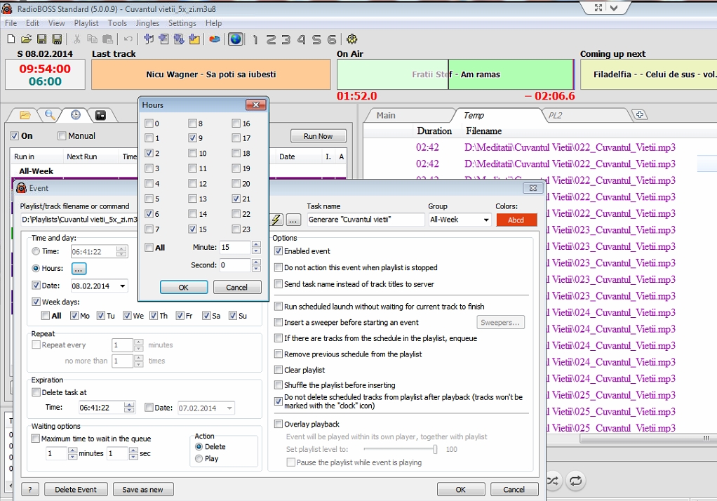

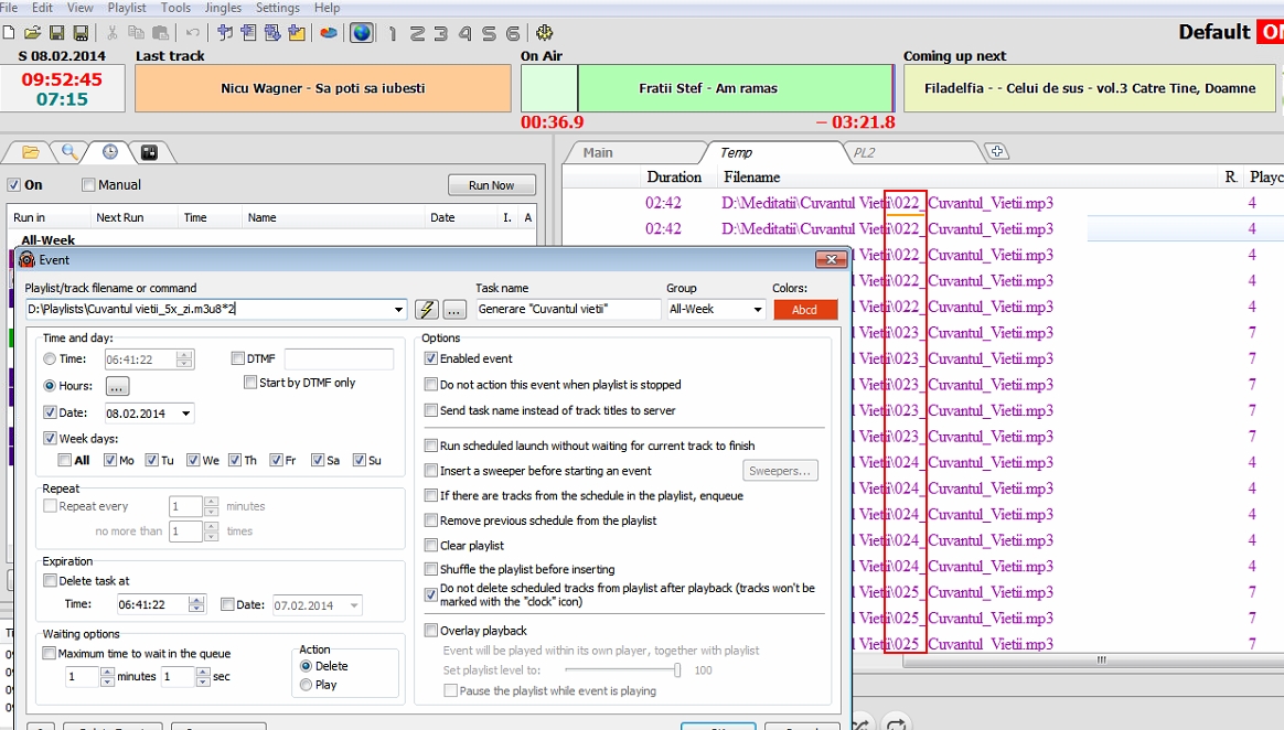

Dmitry, I think that there is a BUG in RB (rotation).
- I deleted old playlist and I made another one (see picture 1) like you told me to do (http://www.djsoft.net/smf/index.php?action=dlattach;topic=3615.0;attach=4424;image). The new playlist file start from number 022.
- I made another event in Scheduler exactly how you teached me.

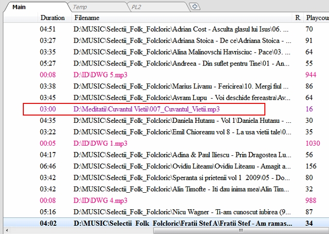

- I restarted RB but surprise. In playlist plays another track than in playlist file. There is the track number 007. Where from RB took it?
I am totally confused. How RB works about rotations? In this situation RB is unpredictable.
There was an issue with Track List cache (discussed in another topic here), it was fixed in RB 5.0.2.

Yes, there's an option in the Category properties, on the Tracks tab - "automatically advance to the next track on each generation".
In Event I will add with wizzard "Perform an action" and "Run Playlist Generator".
So, PGPro will load the playlist (wich contents all tracks copied four times) and it will be set "In order" and "Advance on each generation". I will try it.
OK, please let me know how it goes.
It's just a different way. The Track List option will also work - in the future it will not be changed and you won't get the problem you've described here: http://www.djsoft.net/smf/index.php/topic,3615.msg16605.html#msg16605
