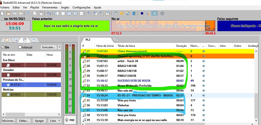

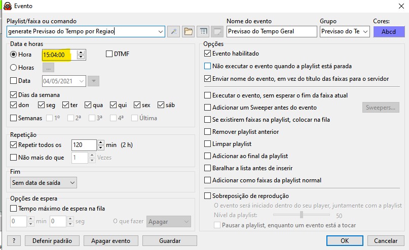

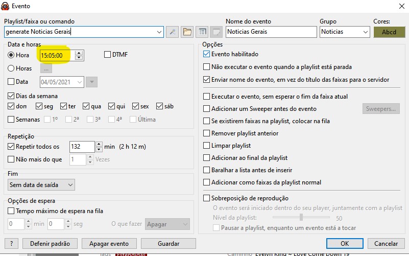

Below are the screenshots.
Event scheduled at 15:04 and 15:05 (example).
The music is playing and at 15:04 it loads the corresponding event (blue) and at 15:05 it loads the corresponding event (green). Within a logic, the event of 15:05 hrs should be loaded after the event of 15: 04 hrs, but while the track is playing, the event with a later time loads over the previous programmed event.
None of the events have the "If there are tracks from the schedule in the playlist, enqueue" option enabled, you should enable it if you want events to be queued one after another.
