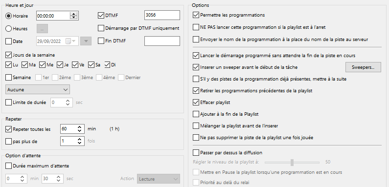

here is the configuration :

I use DTMF but at each hour, so, sometimes Sweepers works anyway, strange ??!!
Sweeper is loaded couple of seconds before event's start time. You don't have "DTMF Only" option enabled, meaning that the event will start by time if DTMF will not arrive. In this case, it inserts a sweeper.
I don't think using sweepers combined with DTMF events is a good idea. Sweepers are designed to work with events that start on time - only in ths case it's possible to calculate how many time it needs to fill with sweeper.
