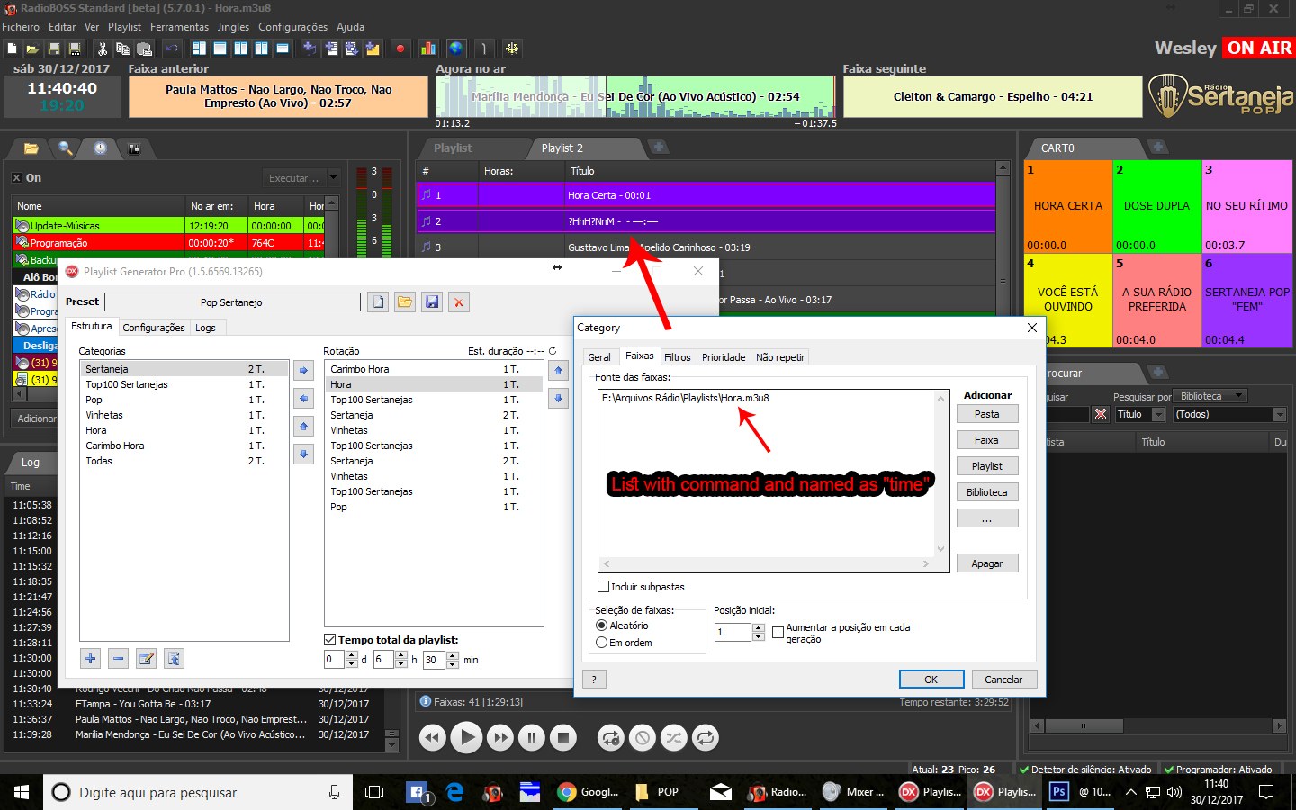

You can create a playlist with this command, name it the way you need (playlist name will be displayed) and insert playlist instead of the command, using the Playlist->Insert playlist menu command.

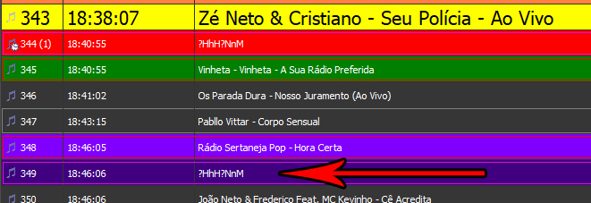

The way it suggested works perfectly, I've used it on the playlist generator by inserting the list with the command, after generating the playlist it shows the command and not the list name.
Playlist generator does not insert playlist by itself - it inserts tracks from the playlist, so that's why you see individual track names instead of playlist.
What command do you have in the playlist?
