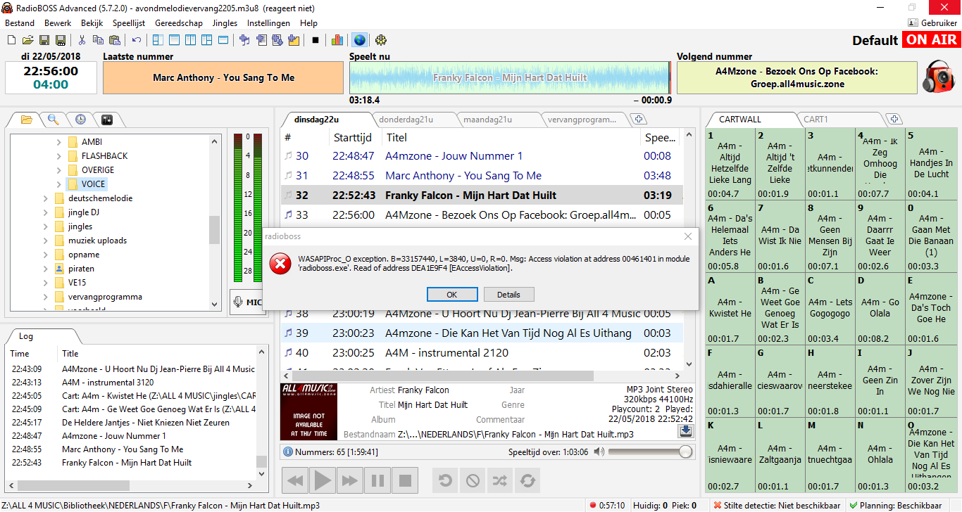

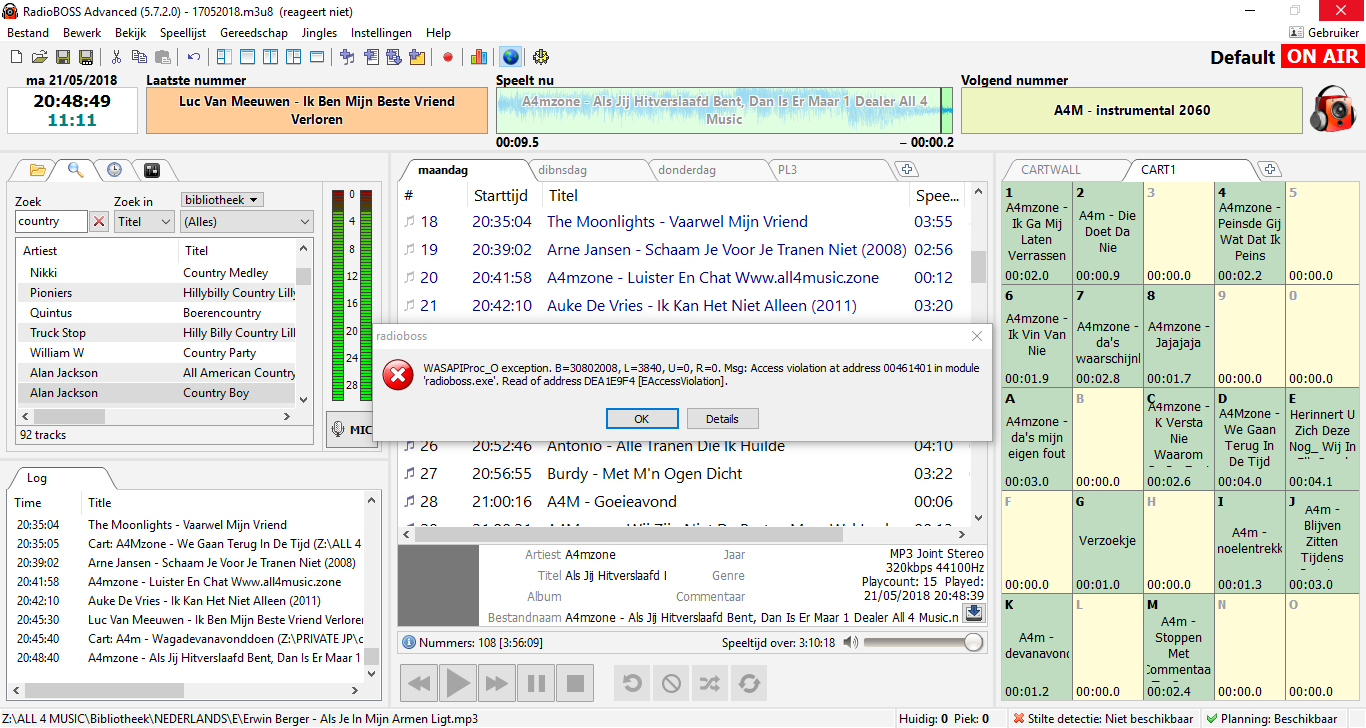

Hi Guys,
Radioboss was downloaded from djsoft.net. I have asked him to make these screenshots.
Switched audio source and input from wasapi to directsound but this keeps happening. One of our dj's is affected by this since version 5.7.0.7.
Any idea what it could be? I was thinking audiodriver but i'm not quite sure.
The error message is about playback device in WASAPI mode. Sometimes this happens because of faulty sound card driver. You should switch playback devices (Main sound card and Monitor sound card, if used) to use DirectSound.
Got some new info:
It seems to happen only when he is connected to a server and adds music or tracks to the playlist during a live broadcast. When he is not connected and making a recording everything works just fine.
I'm about to install the drivers again but..... shouldn't this also happen when he is not connected to a live server?
Installed the audiodriver again (replaced the microsoft one) and now it's running normally.
In the end nothing more then a driver issue.
