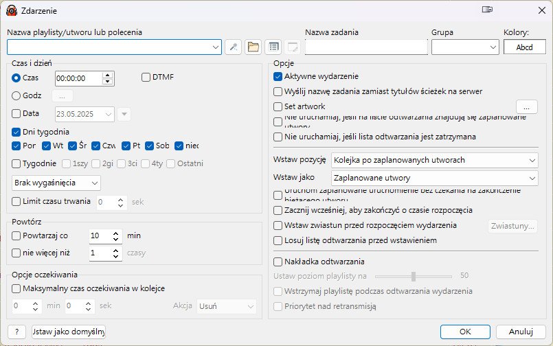

Window for adding items to the scheduler
RemiX
I would like to report a minor inconvenience when using the scheduler. The window for adding an item to the schedule appears to be misaligned in the Polish language version of the program. Some options are overlapped by others, making them unreadable and making it difficult to properly configure the scheduled event. I am attaching a screenshot.
It looks like you have increased the font size too much, so that letters do not fit in the allocated space.
Instead of increasing the font size, it's better to use Zoom: in Settings, View, Style see the "Secondary windows zoom", adjust it as needed. The zoom will increase the entire window size.

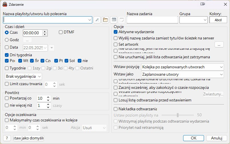

Unfortunately, after reducing the font size and selecting the "Secondary Windows Zoom" option to change the zoom, the window appears larger, but some options are still covered. So this does not solve the problem.
Edit: problem solved, but font must be very very small, must be set to 7 pt or less.
If you set the font to 7pt and use zoom, e.g. 150%, then the actual font size will become about 11pt (fonts are also scaled according to zoom option). Some strings may not fit, it depends on the translation, in some cases the sentences are too long.
Max zoom can to
Max zoom can i set in RadioBOSS options is only 130%. And font is still too small i think.
Generally, if the font is small for you, you should use Zoom to increase the entire window size. Making font large without using zoom will result in text that will not fit in the allocated space.
