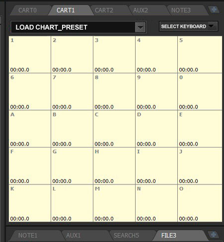

1. if you use a graphical configuration like the one I presented days ago where to access different panels (ADS, PLAYLIST GENERATOR, TRACK TOOLS, WORK ZONES, RECORD VT etc ..) are accessed through icons placed in the foreground on the main screen , it would already be useless to assign keyboard commands to access them (CTRL + 1 / L / H ...)
2. Assign different keyboards from RB
3. Move all the commands useful for the RB broadcast on the function keys eg.
F1 = PLAY
F4 = STOP
F5 = NEXT
F8 = MIC
so you do not incur accidentally press them ...
3. You could have the possibility to load the various presets of the jingle table (chartwall), replacing it and loading it quickly from the drop-down menu "as in photo". Now it's feasible but the process is longer ...
Then you could have a menu to choose the keyboard to assign to that chart as I said before (if you can do it, since you can do)

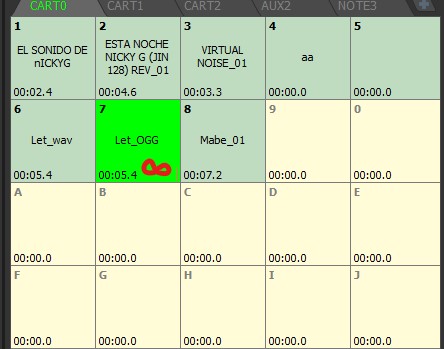

I wanted to send you the video, of the problem with the loop. as you see it stops after 2 cycles of loops and sometimes after 1 cycle. (I start the loop and then I do not press anything anymore, but it stops anyway).
      video:  www.virtualnoise.altervista.org/loop.mp4
1. Can I add a Loop icon (infinity) in front of the tracks with this setting? so you know visually which are set in loop?

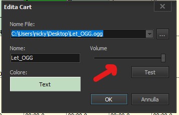

2. Is it possible to set a 1-100% numerical scale in the volume control? Can the volume value also be displayed on the cartwell?
The problem is seen on a video, thank you - will be fixed in the next update.
Yes, should also be added in the next update.
is it possible to add the volume as a visualization?

Currently it allows loading carts from different folders, while using a menu will only show a list of available presets. I think, we'll try to change it to the menu in the next major update and see what happens.
The logic would be to save the PRESETS in a single folder, so it would be good to have a folder where presets are saved and have a drop-down menu that shows me the presets to load them instantly. (doing so you can use less TAB cartwall and have all the presets available.
It would also be useful to be able to copy and paste files from one cartwall to another.
There is a danger in making cart wall buttons cluttered...
Yes, this makes sense. This is actually what we did with profiles in RadioBOSS 5.8, and it turned out to be a good solution. Noted for the future versions.
