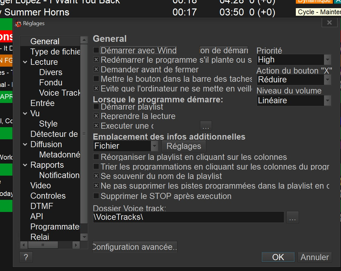

Already present in radioboss 6.2 then in 6.3 on my 4k screen, the software is struggling to follow the responsive, which makes using the software impossible.
Would it be possible to make a correction ?
(Restarting the software does not fix the problem.)

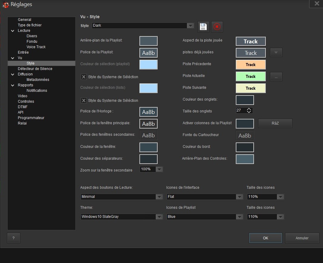

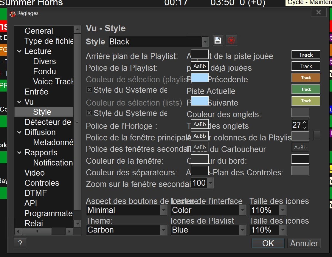

Please open Settings, View, Style, select one of the predefined styles - this should fix it.

The only potential problem is when you drag RadioBOSS window between screens with different DPI, this leads to re-scaling of the window and sometimes (due to bugs in the UI library RadioBOSS uses) it's not performed correctly. But if RadioBOSS stays on one screen (at least, its main window) there are no problems, 4K or not.

RadioBOSS works fine on 4K/any other hi-DPI screens, but looks like it poorly handles DPI changes. Mostly this problem lies in the libraries it uses to build the UI, so once they are updated, this will also be fixed in RadioBOSS. We'll also see what we can do about it.
