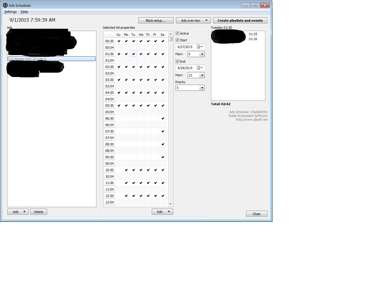

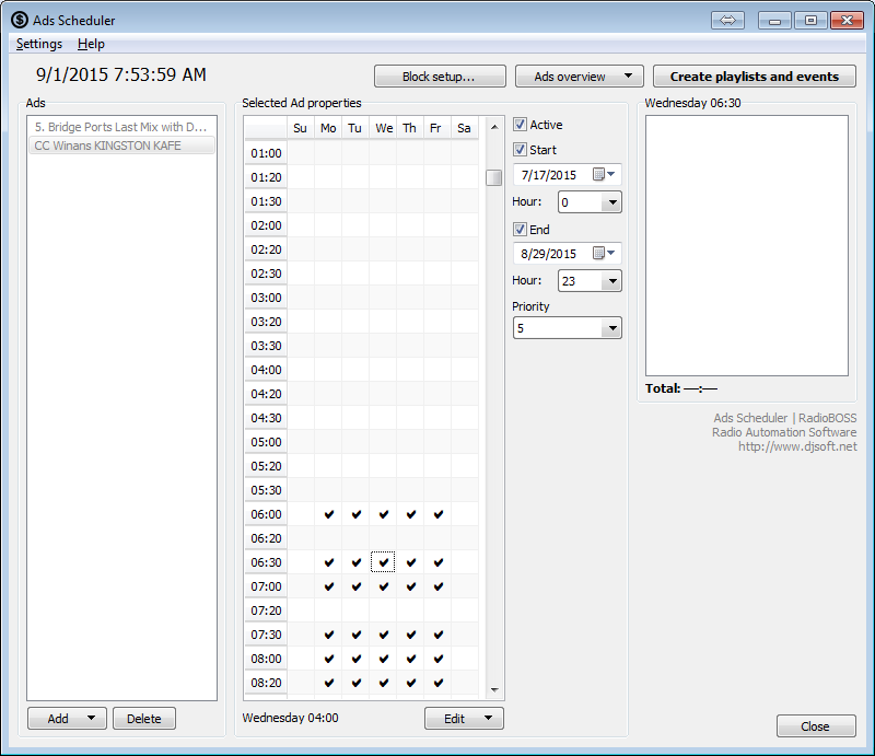

I have an issue where adverts in the ad scheduler doesn't stop playing or gets deleted after the end date passes. it only goes grey but the advert is still playing. Is there any work around for that? Or a fix?
OK, when/if it happens again, please make a screenshot of the event which works incorrectly.
It's greyed out but some how it's not updating the file that's saved or removing it's when the end date and time comes up

The start and end dates are only processed when you click the Create playlists and events button (manual update) or when you run the adsupdate command from the scheduler.
I normally do the Create playlists and events. It use to work that way before but now I have to go in and remove the file and then do another Create playlists and events
