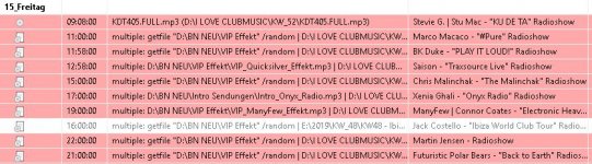

I made a test. In the playlist generator I made a list with 3 files: Intro Jingle - Show - Outro Jingle.
In the Event the playlist is checked "Send task name..." and yes, it sended the task name to the website.

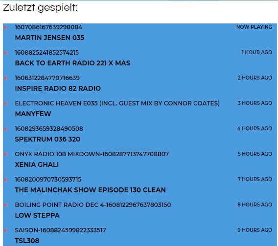

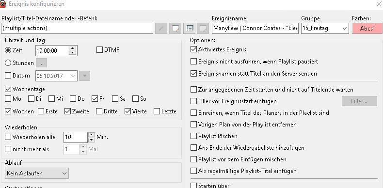

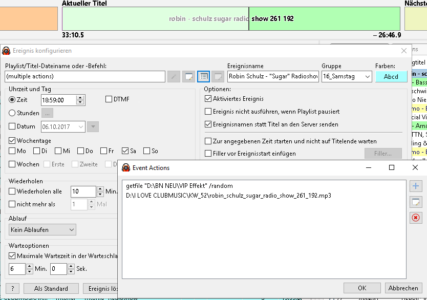

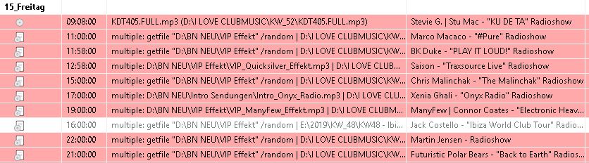

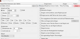

it is not working on my side with the actual version (6.0.1.9.). I attached some screenshots @djsoft

I create a multiple action like you. 1. action - Jingle (Play one track from folder) and 2. action - Songs (Play all track from folder). And yes, for the first action JINGLE it not send the task name, but for the second action "Play all track from folder" it send the task name. And it sends for all songs from the folder.

If you use multiple actions and one of them is generate command it will not work. I suppose it never did.
Maybe it did not send the title for Jingle because it belongs to a file type? Did it send a wrong title or did not send a new title at all?
Yes, you're right. I have Jingle as File Type and set > Brodcast title> Do not send title.
When I choose "Use track title" or "Use custom title" everything is fine. So then it sends Task name for both - Jingles and songs.
