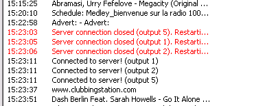

    I regularly, let say once every 2 or 3 days, get disconnected from Icecast server.
I am running 2 radios (2 RB) with respectively 6 streams : 2 mp3 (1 Icecast + 1 Shoutcast), 2 AAC+(1 Icecast + 1 Shoutcast), 1ogg Icecast and finally 1 mp3 to Radionomy servers.
I am getting disconnected from the Icecast server regularly but not from Shoutcast server or much less often.
The two radios are not getting disconnected from the Icecast server at the same time.
RB server and Icecast servers are all guest virtual machines on the same host. Shoutcast server is a separate physical server.
Any idear why this happens ? I am loosing 80% of listeners most of them are on Icecast! and it takes hours to get back to normal
I included screenshot. Server 1,2 and 5 are Icecast, 3, 4 and 6 Shoutcast.

Well, this may be an Icecast issue, as Shoutcast streams work fine.
Try updating to the latest Icecast version - 2.3.3, it was released recently (http://www.icecast.org/). As their news say, many bugs were fixed in that release, probably disconnect issue will be gone.
