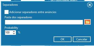

I would like it to be possible for the commercial programmer to also accept commands such as teaser, time, and others. the reality we have around here is that a company sponsors the hourly ad. The teaser can also be used to announce an upcoming song after commercials. That's how radio stations work in Brazil and in many countries. Another thing is that the separators that are already good with the addition of probability also accept tracklists, so we don't need to separate the separators in a specific folder, and these also using replay protection as is done in other parts of the program.
Track Lists are typically used to select music tracks, while separators in Ads Scheduler are unlikely to be music tracks. Why use Track List there? When creating blocks, the Ads Scheduler tries to not repeat the separators. Also, if Track List is used, it wouldn't be possible to reliable calculate the block duration.

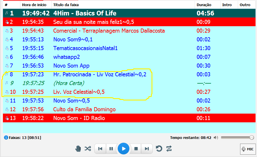

I think the idea was not well understood, it is true that you can do this in the output of Block Intro and Block Outro, however what we do in the block intro and block another is to leave a jingle from the broadcaster of about 15 seconds at random. My idea is to be able to do this at the right time and others, within the block as shown in the attached figure 1.

As for the separators, it is to give the option of using Track List to use exactly as it is used searching in folders only with the difference of being able to create these lists with the content without needing to create a specific folder and in the same way as you create Block Intro and Block Outro being able to process the jingle in the generation, that way it would work of pointing to a folder. The content we use is small jingles of 1 to 2 seconds. In figure 2
The advertisement block is not supposed to have any teasers for music tracks, this will make things unnecessary more complicated, I'm sorry.
Using Track List there will not work because it'll make impossible to calculate the advertisement block duration - Track Lists are only evaluated on playback, and not before. So this is not really practical.

I just want to demonstrate that in Brazil and other countries we use the time announcement option as I have shown. In this way the company (XX) announces the time and then the commercial of the company (XX) goes on air.
In any case, the program does not count the time of separator, Block Intro and Block Outro in the advertisement block duration count even if we check the option to process before generating. It only counts the time of the commercials, take the test. The total time appears only when it launches in the playlist.
Another option would be the track tool / voice insert. adding time announcemt command, so we marked the necessary file and it would work perfectly. When I used Zara Radio I did it in a similar way.
I guess it's somewhat possible if you include a time announcement in the block intro - prepare a playlist with a time announcement and set it as block intro.
It calculates separators internally. Using Track List for Ads Scheduler proven to be unreliable (especially for remote ads management), so we won't be adding any new Track List options there for now.
