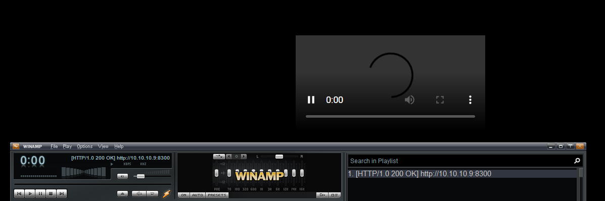

In the screenshot you can see how winamp and chrome are not able to play
From your screenshots, it looks like it connects to the server, but no data is sent.
