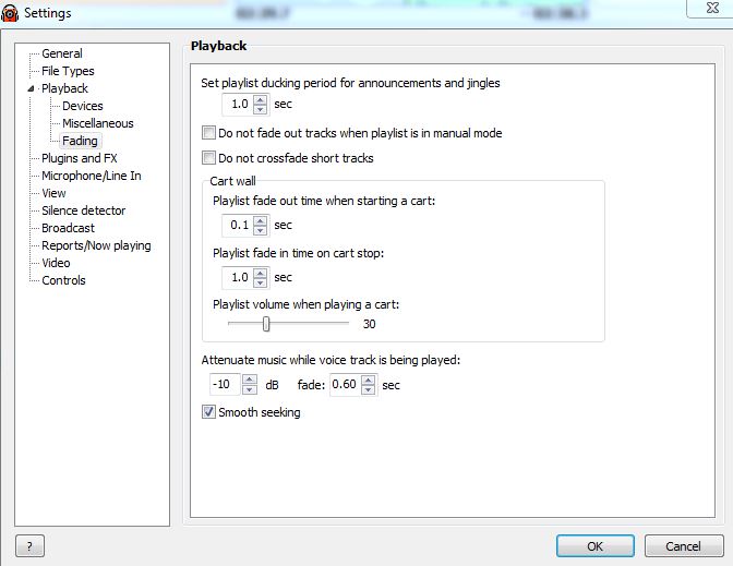

I have attached a pic of my playback settings.  How do I configure the sidechain.  I just want the music to duck whenever I speak into the mic or whenever I play a jingle.  I've set it to 1sec but nothing happens.  also, the voice track attenuation doesn't seem to be doing anything.
On your site there is a tick box to enable voice track in the miscellaneous section, I don't have that option?

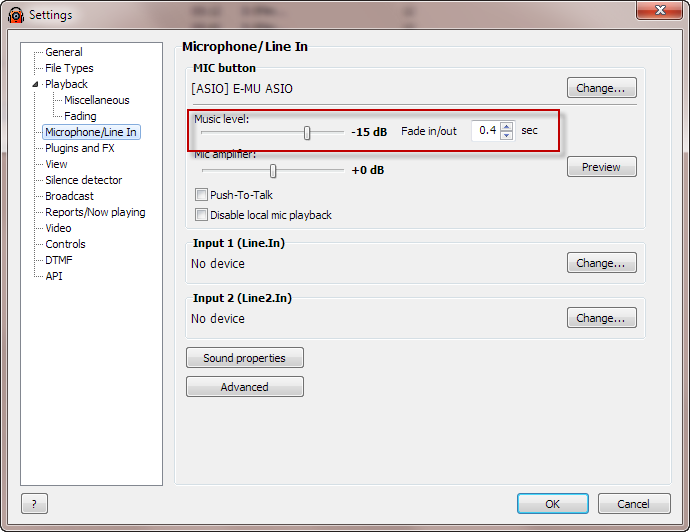

To lower music level while MIC pressed, open Microphone/Line.IN settings tab and set Music Level and Fade in/out settings. Please see the picture attached.
Yes, I seen that option.  I want the ducking to respond to my voice, not the button.
When I press the mic button there is a small click / dropout that occurs in the music.  It would be much better if I could set it so the music ducks when I speak i.e sidechain compression.
