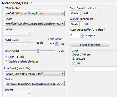

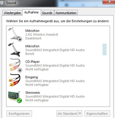

I'm not sure what "microphone always open" means. Does it reads the signal from Microphone input instead of the selected Stereo Mix? Please post a screenshot of the Microphone/Line.In settings window.
When I play music, that's not microphone mute
People listen to music and my voice
I can turn off the Micro on headset, but that makes a loud crackling
When RadioBOSS is not running, is the microphone muted?
All settings are fine. It looks like a feature like "microphone monitoring" is turned on somewhere in the sound card's settings.
RadioBoss is running - no muted
RadioBoss is not running - no muted

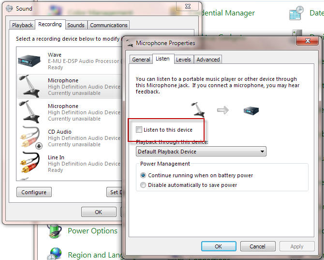

Microphone monitoring is either enabled in sound card's settings (some sound cards have their own control panel), or you have "Listen to this device" turned on in Windows, please see the picture attached.
So it's not RadioBOSS issue...
correctly
i have no control panel for my OnBoard card..
"Listen to this device" is off

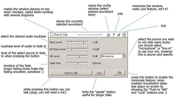

Maybe the software you mentioned - VoiceSwitch - makes microphone to be always turned on?
The error message probably appears because your sound card doesn't allow using 2 inputs simultaneously, if you don't use line.in it you can turn it off: select "DirectSound" and don't select the device in Microphone/Line.In settings.
VoiceSwitch is a solution for Microphone...turned on / off
I have now changed ...
it is now okay ... no error message
