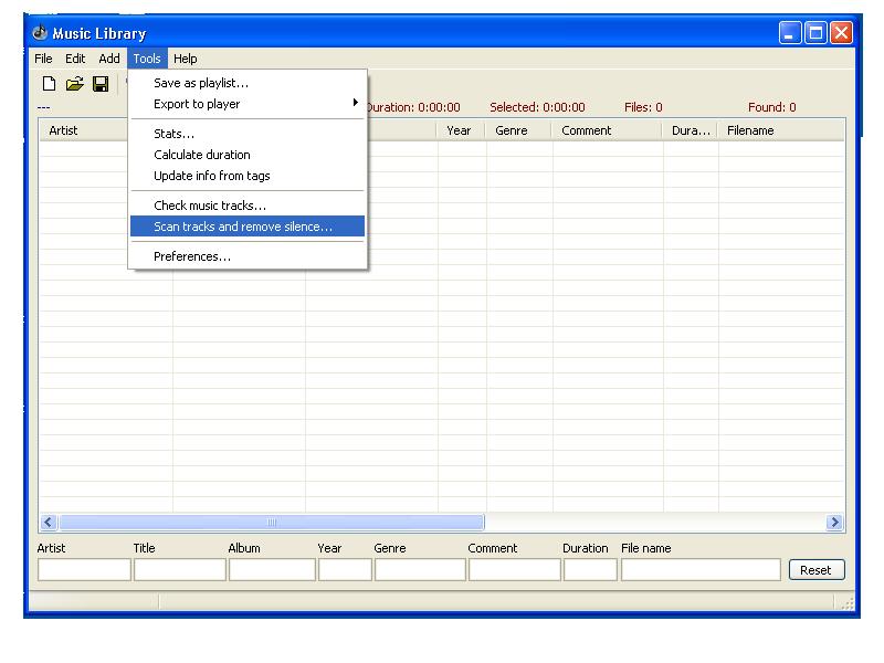

Hi guys i wanna ask about the musical database there is an option that say
scan tracks and remove silence i have a batch of song for test purposes only i have tried in with that option and i still have gap while i have disabled all the crossfades and also the gap killer to notice the effect of scan and remove silence any advice.

Hi, I have a question with this function, that takes into account the values ??set from RadioBOSS to remove silences?, I would like to try it, but I want to make sure this does not change my files and then affecting the crossfader
This function just sets the information in tags (Start/End marks), it doesn't modify the actual file contents. The tracks has to be played in RadioBOSS if you want those settings to have effect.
Yes, it uses the Gap Killer settings from RadioBOSS (Settings->Playback->Miscellaneous). You can try it on a small subset of files to make sure it works as you need.
