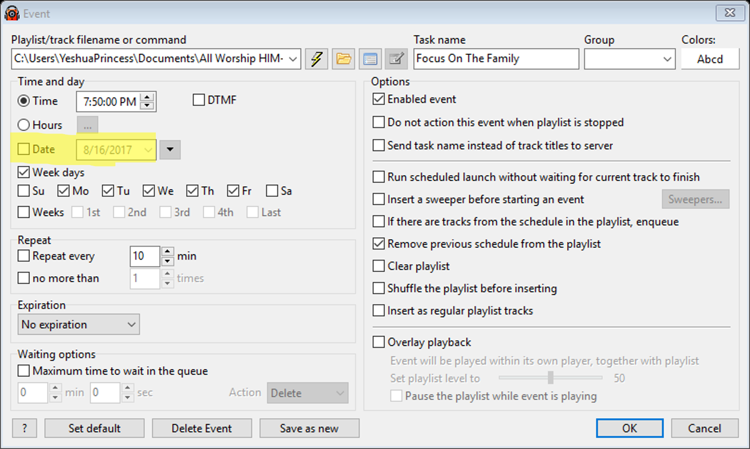

I discovered my error!
I did not check the date box in the event. See attachment.
Therefore, the file retrieved an older file. I checked the date box, and the correct file immediately downloaded!!!!!!
That's still odd as macro is processed using the current date, not event's date.
I was thinking the exact same thing, especially since you did not mention checking the date box in your instructions.
Anyway, the files downloaded super fast, and I set up a separate command to play the file at a specific time in rotation.
Everything was working ok when I set it up last night.
Another company sells a very expensive piece of equipment to do the exact same task as the event manager. This will save our church from having to purchase a very expensive piece of equipment. We will continue upgrading with RB as long as such sophisticated features are offered to make smaller nonprofit stations operate just like the larger ones. Your software is extremely powerful. Thank you.
Checking the date is not required/needed for macro to work. So I think the problem was somewhere else...
