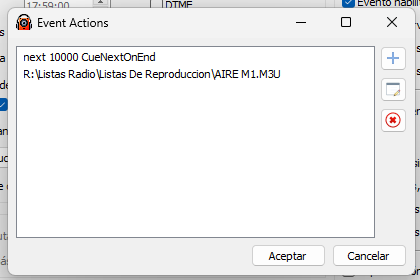

Interesting new feature "CueNextOnEnd", I would like to apply it on events that are executed without being added to the queue.
Is there a way to do this, I tried adding the command to the list that is inserted, but it is not supported.
Thanks
Yes, currently this command is not supported inside a playlist or multi-action event that also contains tracks or playlists. It can be scheduled as a separate event. I'll see what can be done to improve this, maybe the limitation to run it inside a playlist will be lifted.

Hello Dmitry, I have the following command
next 10000 CueNextOnEnd
The command fades out the current track, but after finishing the fade and starting the new track, the track that ended is heard again at full level for approximately half a second.
This is not new, it happens approximately 40% of the time, but it is quite messy on the air.
Thank you, this will be checked.
