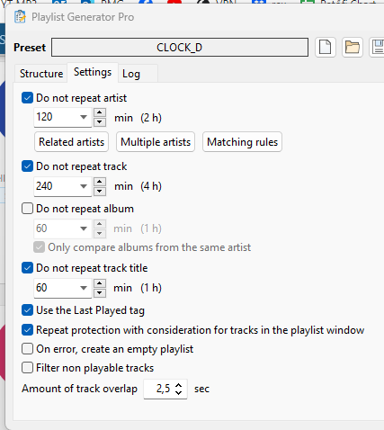

Track selection is random, it only checks if a track fits all the rules and filters, and if so, it adds track to the playlist. Strict repeat protection rules can lead to a situation when Playlist Generator does not have enough "freedom" to select tracks - so lowering repeat protection periods can result in better playlists.

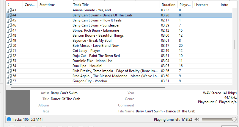

Hi!
I have exactly the same problem. Have you found any solution since then? I'm currently using a 7.0.2.0 version, that's where this problem occurred, I installed it about a month ago.
I attach a picture of the playback rates.
Thank you very much in advance!
Attila

The problem does not confirm, we tested it a lot of times (due to user requests) and, when all repeat protection rules disabled, Playlist Generator will use all tracks from a category, only then it will re-shuffle and start selecting tracks in different order (again not selecting the same track until all tracks were taken).
I will try to turn it off. but then how can i reach
to not play an artist within two hours?
or don't repeat the same song within four hours
Thank You very much for the answers! <3
It's either repeat protection rules, or using all tracks from a category. Even with repeat protection rules, it will try to use all tracks first, before reshuffling.
