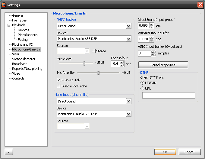

If it still doesn't work in 4.8.0.7, please post a screenshot of Microphone Line.IN setting window here.
Still not working correctly with 4.8.0.7.  Sound is very garbled.  Attached is screen shot of Mic In

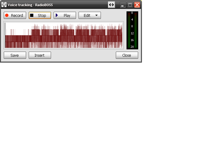

Also included screen shot of Voice Tracking waveform.
