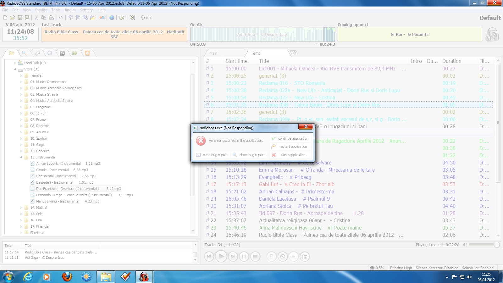

RB crashes many times.
The problem is that it does not start "send bug report".
This situations happends many times in a day. SO, I understand that RB do not support a LIVE radio station?

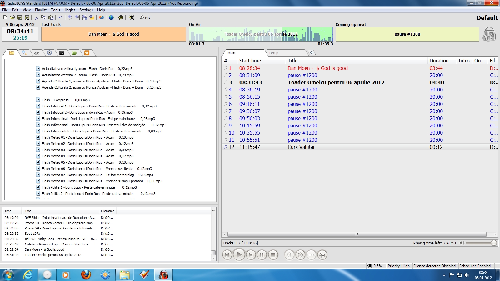

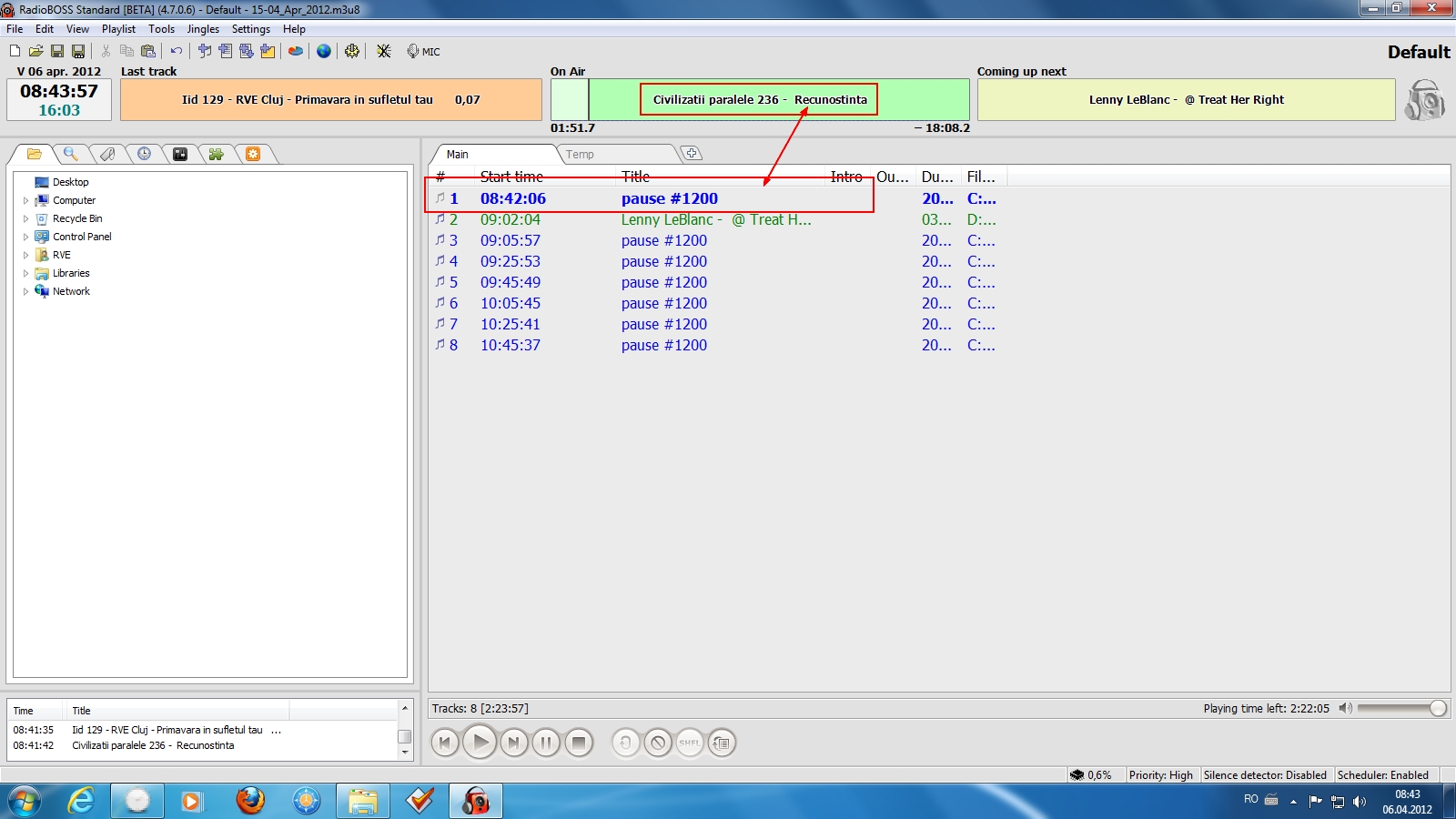

On Air display do not shows pause.

Just making playlists in Temp.
It crashed.
"Send Bug Report" crashed itself too  ;)

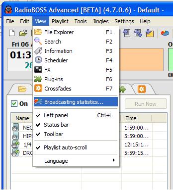

***BUG***
Under "View" menu, the "Broadcast Statistics..." does not reveal the broadcast information window showing radio stream, total listeners, etc.
Image attached
Yes, it's by design. You don't want users to see that you using the pause :) so when you use the pause, it just shows the previous track title.

when this happens again, please click "Show bug report", open the "Call stack" tab and make a screenshot. This should be enough to see the problem.
How often does it happen?
Thanks for reporting, this will be fixed in the next update.
when this happens again, please click "Show bug report", open the "Call stack" tab and make a screenshot. This should be enough to see the problem. How often does it happen?
I can't do that becouse when it happeneds RB freeze. Only Task Manager is the saviour to close the application (RB).
Let me tell you something. I use RB for DWG Radio Romania. For this station make sense what you say, becouse transmition is only for internet.
BUT, at RVE station we try to use RB as main player 24 hours, for Live. It is terrestrial radio station (even if we broadcast to internet too).
I think that have to be a solution for that situation. For example when I use #pause the users to see "Talk", becouse in Live is a Talk Show in that moment. I have 3-4 people in Live studio who debate "The Low of Education". Two or three #pause line, by 10 or 20 minutes help me for a good orientation in playlist (it is about habit here - from the last software) and it gives me a good security that nothing incidental can happened. Believe me is harder to use "Stop after this track". In fact is almost impossible. That's why we use #pause. I told you I work in a radio station from 1988.

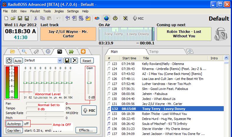

***BUG*** ??? Not sure
Over that past week, I've noticed that the volume on a random track will suddenly explode past normal levels.
1.  I have not added any limiters or regain, since beta 4.7 already has regain.
2.  I am not using the AutoAmp located within the FX module.
3.  And before someone suggest that is may be the track itself, I've replayed the track by moving it down in the playlist only to find out the track plays at the normal level.
So with that said, I'm not sure what the problem is. Thought I would mention it.
So you need custom title for "Pause" command, right? Or just seeing "pause" in the "Now playing" screen will be enough?

A title for pause would be great, THANKS!
Yes, it will be added in the future versions like 4.7.1, no new features will be added to 4.7.0 because I want to get it out of beta version.
