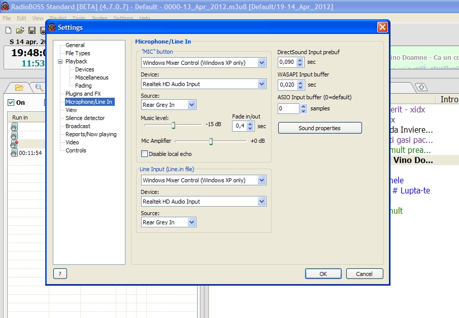

It seems that you're using "Windows Mixer Control" driver in the settings, am I right?
Please post a screenshot of Line.In settings you're using.

The settings in attach.
It works. We don't use microphone with RB

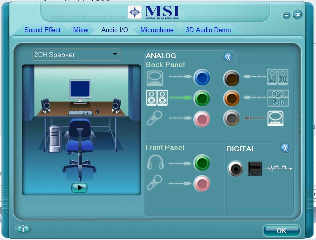

Control Panel for audio card.
It is how you recomanded: Realtek HD

Settings are OK. The strangest thing is that Line.In wasn't changed, especially the "Windows mixer control" part wasn't changer for years. I don't understand why it suddenly stopped working...

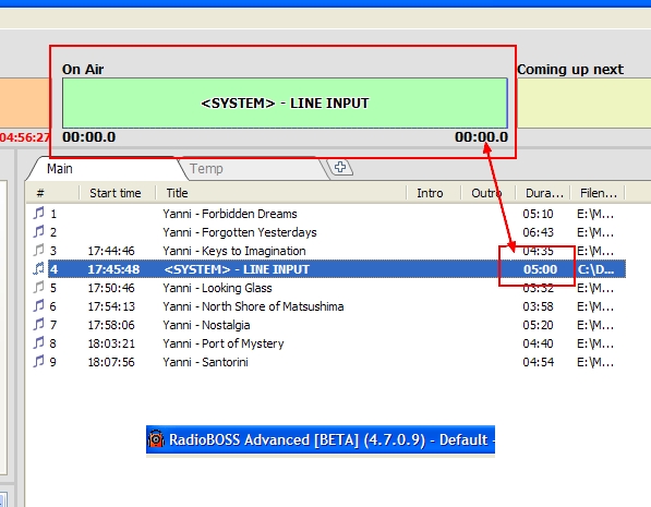

Unfortunately is almost the same bug.
Now is not crashing (I put two soundcard), but it doesn't take the time. Line.IN plays forever.
I tested at desktop from my home, so looks like a software problem for Windows XP. I think is a soft (RB) problem, becouse I used two good soundcard, windows original xp pro (licensed - so, a windows without bugs) and two different PC's.
Please, need fix for that situation.
That's weird. What Windows XP are you using? I just checked it on Windows XP SP3 with all updates, and it works.
You checked it on 2 PC's and it doesn't work on both?
XP SP3.
One is Home Edition (work) and another is Pro (at home).

Sound out is ok, linein is ok. All plays great. The only one problem is that line.in doesn't count the time/duration, as you seen in image. That's why I believe that is a software problem.

An update will be tomorrow, I think this problem will be fixed. It seems that I finally was able to reproduce it.
