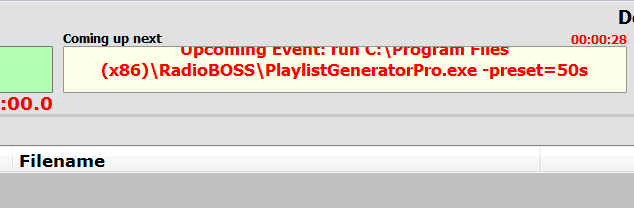

There is a slight display issue in the "up-next" window which wasn't present - that I can remember - in the previous version

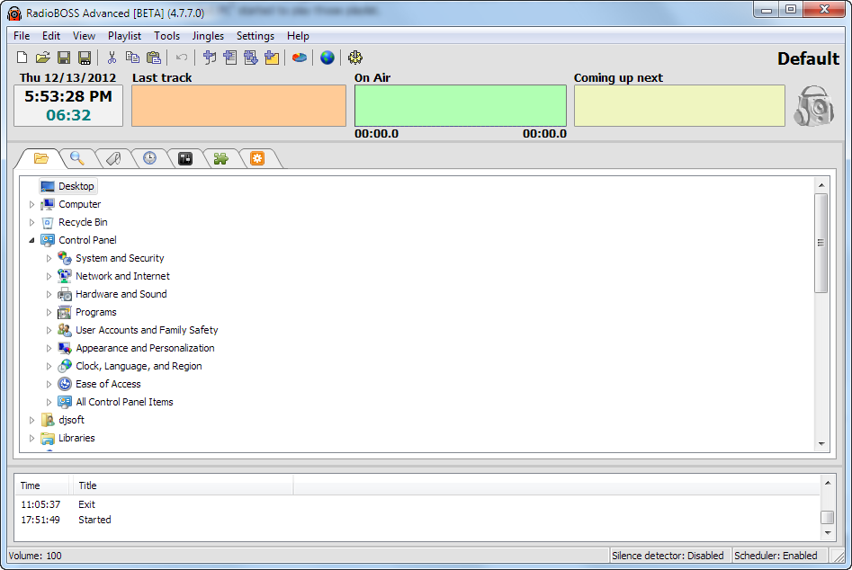

In the "view" menu can we have an option to NOT display the "playlist" window as this has now no purpose on my "Management PC" and is simply taking up space.

You can move splitters to resize areas as you need (see the picture attached).
