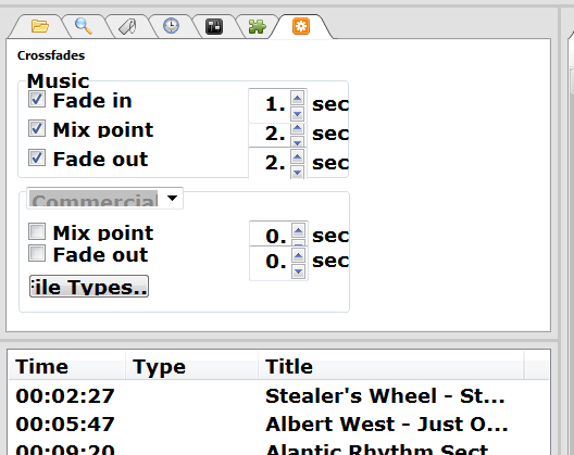

Joshua said:
DPI issue still exists in left window
Can you please post screenshot of a problem? Probably you've set too large font size, and it doesn't fit there...
Font is set to Verdana 11pt Bold - screenshot attached
Setting the "flashing" alert for longer - already set to 30 seconds - would not make any difference.
OK, this will be fixed.
