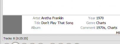

See attachment. In actual fact no artwork is being displayed - just a gray box ? On my Win 7 box (production) nothing happens if I click on the gray image. On my win 8 machine (playout) if I click on the box the artwork pops up - the wrong artwork as it happens !

It displays Gray box when there's no artwork present in the tags (or it can not read it). If you have tracks with artwork embedded but RB doesn't read it, please send those tracks to support@djsoft.net
When artwork present you can click on a box to see it in a full size.
I realised what it was supposed to do but is simply is not doing it!

Done some more testing and have found the following
It definitely takes 2 scans to read files data correctly
I have also noticed that even after 2 scans what is appearing in the Music Library Applications does not match what mp3tag V2.54 is seeing
See the 2 images A & B that show significant differences in the "comment" field - crucial for plalist generation.
When i tried to re-write the tags in Music Library it wouldn't and came up with an error - see image C
