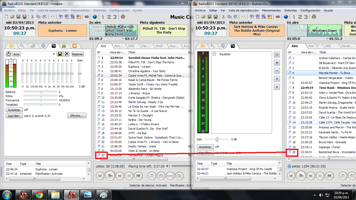

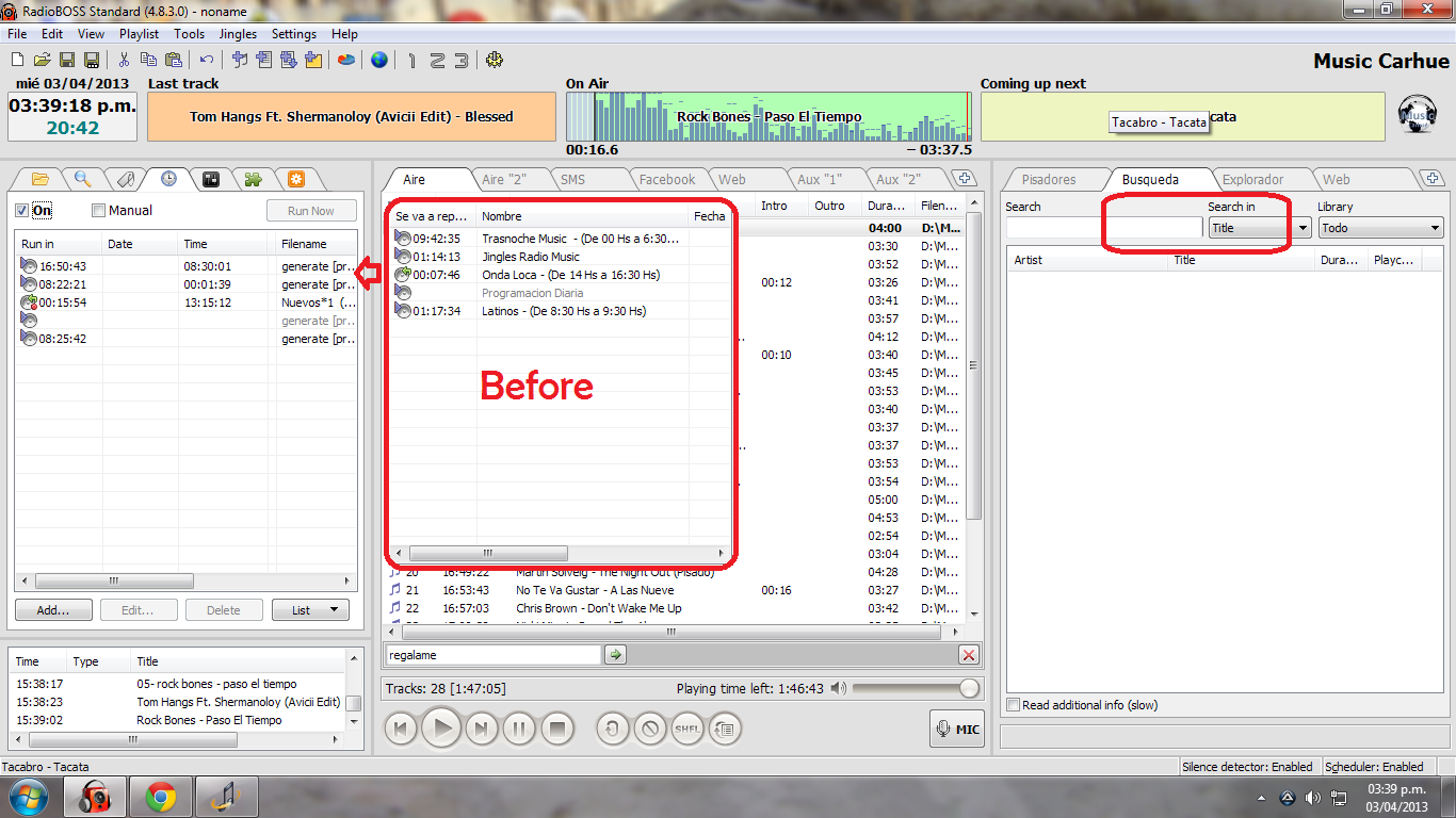

The problem was the following, appeared in front of: Name, Run In, Time. strange names, with empty fields.
When I load the profile again and everything returns to normal.

Hello, interface problems still present over established English language (see Figure 1)

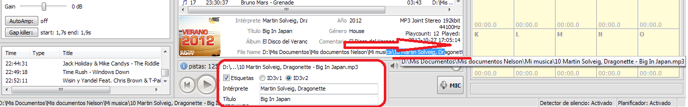

I have a suggestion regarding the file name in the Tag Editor:
When the window size is not enough to display the full path, it would be nice to only display the file name (see Figure 3)

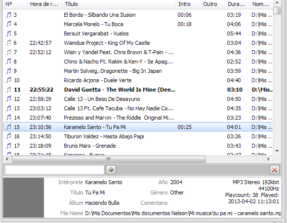

There is a bug in the new editor of tags:
When you edit a file that is not assigned to anything in the field year, the program stores "0"

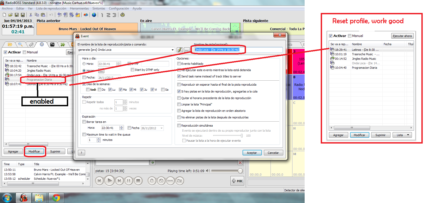

I keep finding errors in the scheduler:
I also realized that incorrectly displays the event list, press the Edit button loads another event.
Also seemed "off" an event that was not, and that should be disabled showed activated.
Again to refresh the profile, everything works fine
Screenshot is from version 4.8, does it happen in 4.9?
Thanks for reporting this.
That's really strange. What other software do you have installed on the PC?
It looks like some 3rd party software can mess with the system... incorrect scheduler list, disappearing "Clear" button. All those issues may have one cause. No other users reported anything like this and nothing like this happens on testing instances here... I think that could be something wrong with your PC.

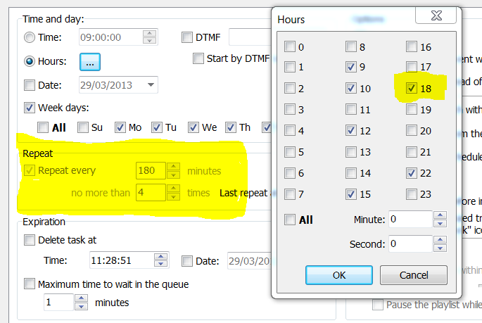

dave-t said:
I have just had a schedule run twice then a schedule ran that should not have run  ??? ???
Can you please give more details on this? Eg. a report entry with double-start and screenshot of this event would be helpful. Same for event which started when it shouldn't.
Hi Dmitry
I have been looking at this "problem" for quite some time and think I can explain both situations.
1. My news bulletin ran twice straight after each other.
quite simply the way I had set the schedule up allowed this to happen. when I first configured the event I had it starting at 09:00 with 4 repeats set for 180 Minutes so that is would also run at 12:00, 15:00 and 18:00.
I then re-configured the event to run at specific times: 09:00, 10:00, 12:00, 15:00, 18:00 & 22:00
However the repeat schedule every 180 remained ticked so it quite simply ran it twice ! - see attached.
Clearly this was a user error although it was quite easy to make the mistake.
2. Schedule running when it was not supposed to.
I have checked a tripled check the event and it should NOT have run at just after 18:00 tonight - however I believe I can explain why it did.
the schedule [1970s] is set to run at 03:00 with 2 repeats at of 540 minutes, so it should have run at 03:00 & 12:00. It did run properly at 03:00
for a reason I cannot explain, I could not hear the stream on my monitoring system at 09:00 this morning. I was distracted by a phone called and re-loaded RB and forced the wrong schedule [1970] to start at 09:05.
the schedule ran correctly at 12:00 but then ran again at 18:05 - 9 hours AFTER I incorrectly forced it to run.
As the schedule was effectively reloaded (when I started RB) and after forcing it to run at 09:05 it caused it to run again according to the repeat that had been set
Hope that makes sense !
we have exchanged emails re the "load" command and suspect that this is the same issue ?

Dave,
1. When you have "Hours" checked, the Repeat feature is grayed out and it's not working (even if you have checkbox there). I'll add this to the list, probably there's a bug. Please post part of reports when event was started twice.
2. The load command is a separate issue and it only occurs when you're using load command. Repeat is not tied to the time when you manually launched, it's counted from the set time, no matter if and when Run Now command was used. I also added it to the list to be checked.

Hi Dmitry
Dave,
Here is the pre-set for the event that played twice one after the other
Code:
[event2]
EnabledEvent=1
DateTime=29/03/2013 09:00:00
FileName=http://www.fsnradionews.com/FSNNews/FSNBulletin.mp3 #0
TaskName=FSN News Weekday
UseDate=0
Immediately=1
Above=0
MuteLev=100
Days=0111110
DelPrev=1
DoNotRunIfStopped=0
PausePlaylist=0
Shuffle=0
Repeat=1
RepeatPeriod=180
RepeatCount=4
Enqueue=0
ClearPlaylist=1
UseDaysOfWeek=1
Hours=000000000110100100100010
Minutes=0
Seconds=0
TimeType=1
MaxTimeWaitOn=0
DoNotMarkAsScheduled=0
MaxTimeWaitSec=60
TaskNameAsTitle=0
DTMFOn=0
DTMFString=
DTMFOnly=0
FontColor=-16777208
BackColor=-16777211
DelTask=0
DelTaskTime=29/03/2013 11:28:51
DelTaskUseDate=0
And here is the pre-set for the schedule which ran when it should not have
Code:
[event5]
EnabledEvent=1
DateTime=12/12/2012 03:00:05
FileName=R:\Playlist\70s.m3u8
TaskName=70s Daily
UseDate=0
Immediately=0
Above=0
MuteLev=100
Days=0111110
DelPrev=0
DoNotRunIfStopped=0
PausePlaylist=0
Shuffle=0
Repeat=1
RepeatPeriod=540
RepeatCount=2
Enqueue=1
ClearPlaylist=1
UseDaysOfWeek=1
Hours=
Minutes=
Seconds=
TimeType=0
MaxTimeWaitOn=0
MaxTimeWaitSec=60
TaskNameAsTitle=0
DTMFOn=0
DTMFString=
DTMFOnly=0
FontColor=-16777208
BackColor=-16777211
DelTask=0
DelTaskTime=12/12/2012 23:14:33
DelTaskUseDate=0
and here is the log which show both "issues" running one after the other
Code:
17:57:05;;"Aurra - You And Me Tonight";"R:\Library\Top 40 Charts\1980s\Top 40 - 1986\Aurra - You And Me Tonight.mp3"
18:00:00;scheduler;"Schedule: http://www.fsnradionews.com/FSNNews/FSNBulletin.mp3 #0";"http://www.fsnradionews.com/FSNNews/FSNBulletin.mp3 #0"
18:00:00;;"http://www.fsnradionews.com/FSNNews/FSNBulletin.mp3 #0";"http://www.fsnradionews.com/FSNNews/FSNBulletin.mp3 #0"
18:03:03;;"http://www.fsnradionews.com/FSNNews/FSNBulletin.mp3 #0";"http://www.fsnradionews.com/FSNNews/FSNBulletin.mp3 #0"
18:03:35;scheduler;"Schedule: 70s";R:\Playlist\70s.m3u8
18:06:08;;"(jingle) - ATH 70s INTRO";R:\Cart\Intros\INTRO-ATH-70S.mp3
18:06:17;;"Ken Dodd - Think Of Me (Wherever You Are)";"R:\Library\Top 40 Charts\1970s\Top 40 - 1976\Ken Dodd - Think Of Me (Wherever You Are).mp3"
Dave, OK, thanks for details. For repeats, although values are stored in the event properties, it's not used in operation. And the repeat feature is grayed out in the scheduler window when Hours option is selected
By the way, did it happen again? Or this happened only once?
Regarding double start: are you sure there's no other event which can launch at 18.00.00 to start http://www.fsnradionews.com/FSNNews/FSNBulletin.mp3? Report doesn't say if it's the same event or not. Technically it's impossible for event to be started twice - that's why I'm asking so many questions...
It has only happened once and I have waited the full 24 hours before replying to ensure that it did not happen at 18:00 UK time
I have checked and doubled checked the pre-sets and I cannot find anything to indicate that it was scheduled to run twice.
The ONLY difference yesterday was that I reloaded RB and that is where my suspicions lie.
as I am running different schedules at the weekend I cannot properly test this until Monday but would be happy to run the same schedules on another machine and reload RB to see if I can replicate the "issue" ?
Dave,
A little test here with the events you posted didn't reproduce the problem... Please let me know if this happens again.
