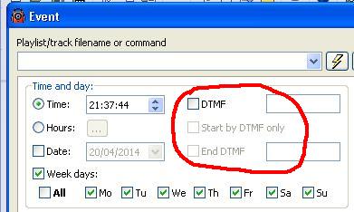

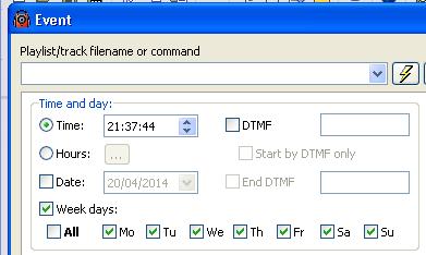

Also another alignment in Events window will be good to become like the second picture .
Yes, it looks better. Will be changed in the next update.

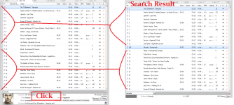

Found one more alignment to become like the second picture. Or may be this must be like that ?

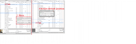

a problem that is old:
to move the cue player, then if before stopping cueing, changing lyrics (by double clicking on another song from the list, oviamente this option has to be enabled in the settings), the player cue is positioned on the position original.

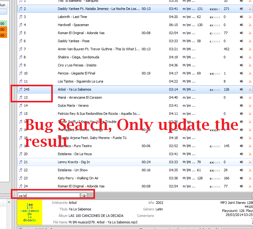

there is a problem when looking at a list of songs reproducion:
The list is not updated until you mouse over the tracks.
It has to be like this.
Can you please give more information on it?

1-there is a bug when looking for clues in the list.
2-Simple problem with the location of the cue player.
The picture will be enough
Can you please explain this in mode details?
Also what OS you're using - I see that rating shows "<<" instead of stars in the playlist.

Regarding the problem you reported:
1-I charge a playlist.
2-I do a search in the list.
The scroll moves and the song that found a match is selected.
problem:
They continue to show tracks which placed the first position in the list.
Only the selected track is updated.
See the picture.
