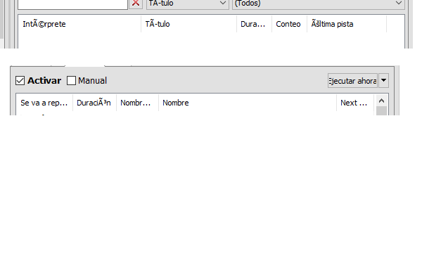

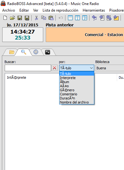

Bug in latest Beta.

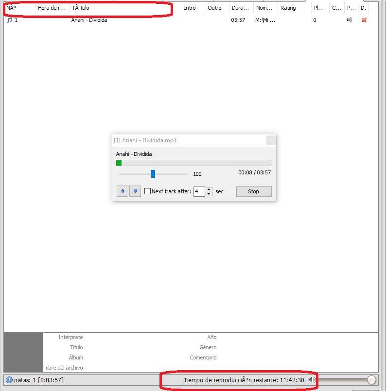

Bug is still there - incorrect playlist time calculation.
It will be not a problem if I should not uninstall it, but I have to uninstall RB Beta all the time when a bug is reported as fixed, but it is still a... bug  ???
I cannot move forward to test it becouse of the same bug...

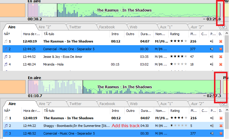

Dmitry, here other problem:
If to start playing a track then continues with a file type "Overwrite crossfader" that mixing point is established, for more then a track is added, which does not have any type of file uses the crossfader that had the kind of archive.
Or if the file that contains the "file type" is removed.
In the example the default mixing time is 3.5 sec.
And the file type 0.5 Sec
As can be seen the mixing time is always the same.

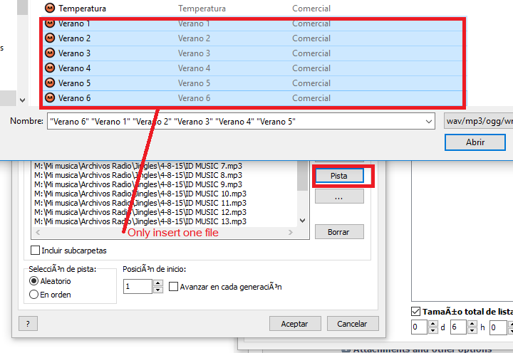

Small problem with Plan Pro.
When multiple tracks are selected, only inserts the first.

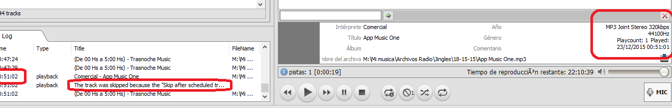

I think that is a bug.
When playback of a track is omitted, as the playcount adds and updates the last playback.

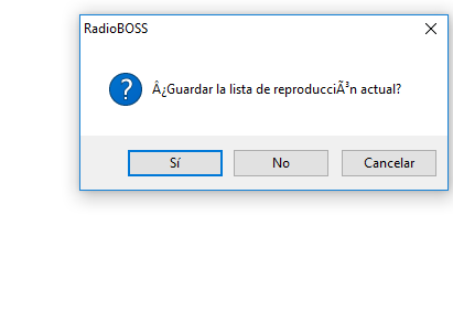

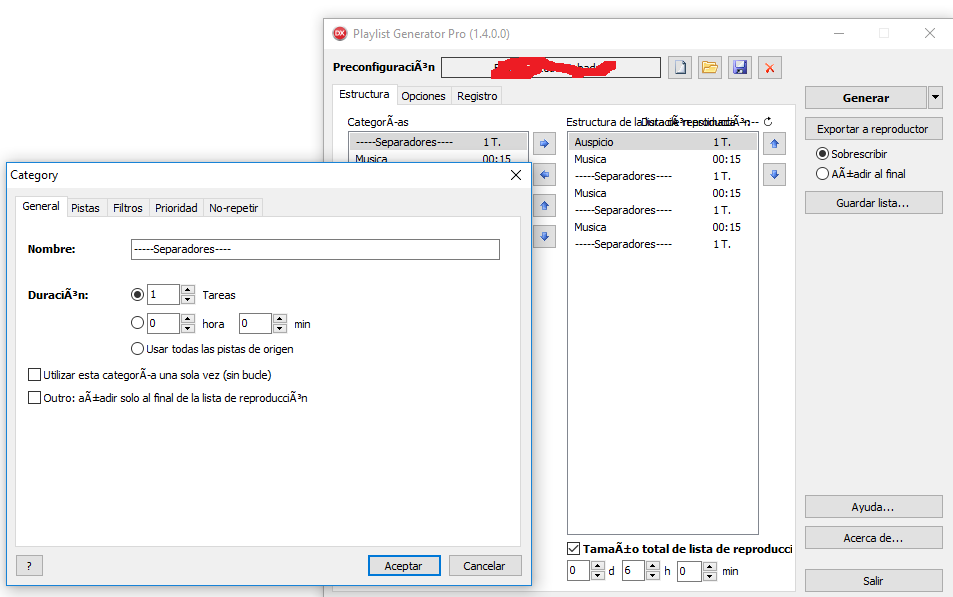

Bug in latest Beta.
Thanks for reporting, it appears that translator saved the files in wrong encoding.
Yes, the same bug was fixed for the active playlist, but not for additional playlists - will be fixed in the next update.
It seems that mixing time is not recalculated - will be fixed.
Thanks for reporting!
Yes, it appears to be a bug.
