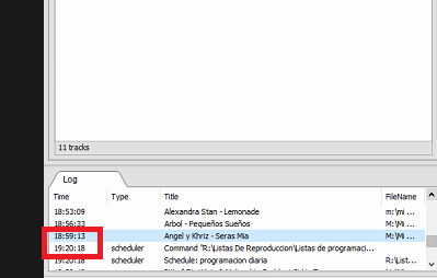

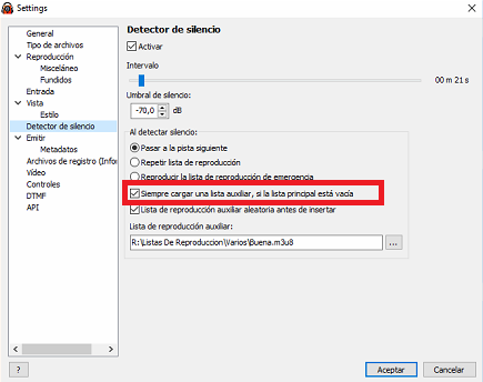

I found problems with the detector of silence.
The "Load auxiliary reproduction list if the list is empty" is not working.
My Playlist ended today, and spent 20 minutes in silence until I noticed. (You can see in the screenshot)
