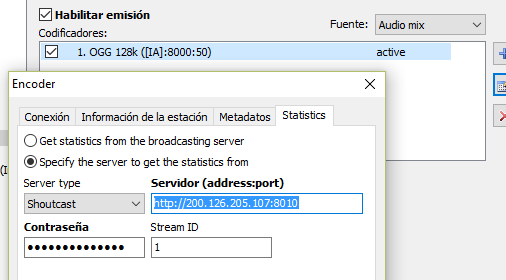

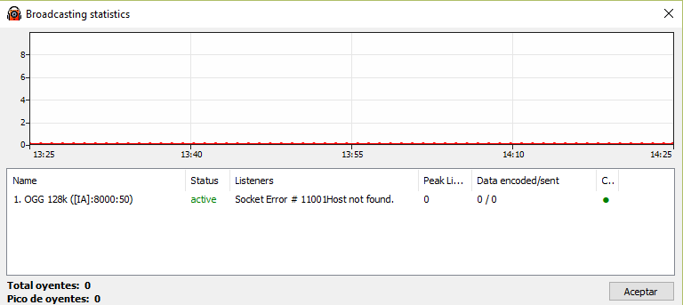

I'm testing with shoutcast V2.
I have the error "socket error # 11001host not found".
in the field stream id have "1" (the number of shoutcast stream)
When typing that ip and server browser entry correctly to the web server
The password that I use is that of the server administrator or RadioCaster which use to connect to the server?
The "host not found" usually message means that the server or port is specified incorrectly. Also, you should try using the source password (in some cases, admin password should work too). Can you send a screenshot of your stats relay settings?

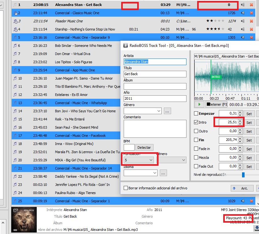

Bug in the metadata editor:
to confirm a change there is that press two times save. (and the key enter the same,very uncomfortable)
Another mistake: I want to delete the year of song. I get the text, option of duress twice the button Save and the year appears again.

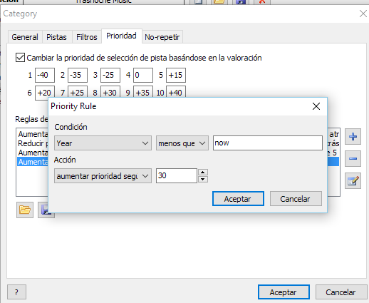

New priority rules: Year
Happens with the configuration of the as (month that, less that). Be omitted?

Here attached the screenshots of my configuration.
The server should be specified without the "http://", leave only the hostname and port.
That's strange. Can you please send the file for which the tag editor requires double-save (and can't remove the year) to support@djsoft.net ?
It only considers the year. It is rare when songs have month or full date specified...

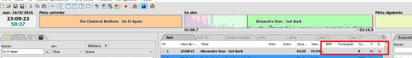

Another bug:
sometimes disappear data of the current track from the list. (I'm using queuque mode). Display correctly until the track began to play. (happen sometimes)

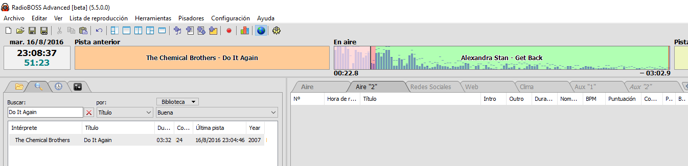

Problem with the intro bar continues to occur. (Do not be seen)
Sometimes works and then stops working. I can still not give me that is what triggers it to work or not

I'm testing the feature to increase the priority for tracks of this year. However I do not feel that is working. There are few songs of this year generated lists.
