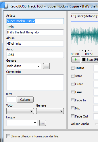

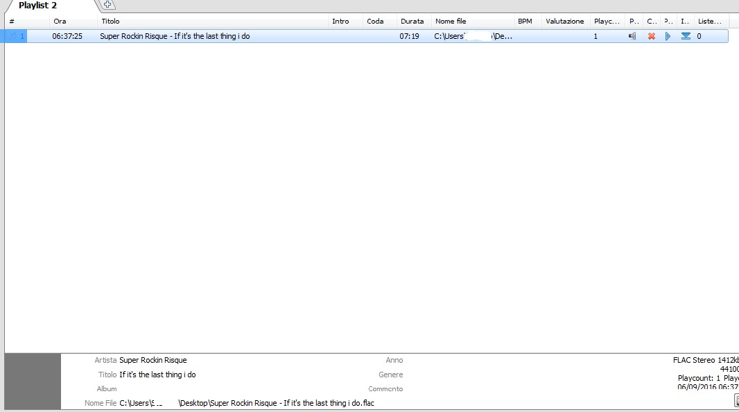

Good morning, I noticed that the tags are incomplete
It looks like that you disabled tag reading (in Settings->Playback->Miscellaneous) and it extracts only artist/title from filename.

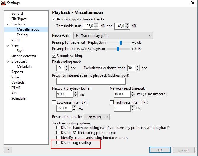

Take a screenshot from your RadioBOSS Settings - Playback - Miscellaneous, like in my image
