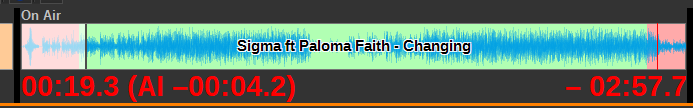

At times I get an issue with the Sweeper playing after a  few seconds of silence.
The sweeper is trimmed but looks like it has a long silent tail in this screenshot and only starts to play half way.
I think it moves between 3 and 5 seconds
It happens a few times, but it is very unpleasant to the air.

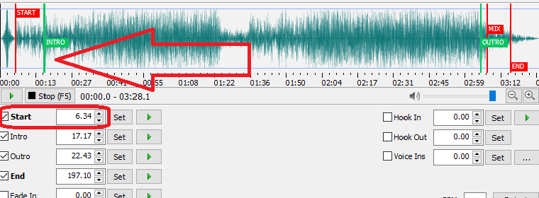

I am able to reproduce this.  In my case, it seems that the sweeper will delay triggering if I have trimmed the beginning of the music track by placing "START" a few beats into the track (See Images).
If I don't trim the track, the issue is not present.

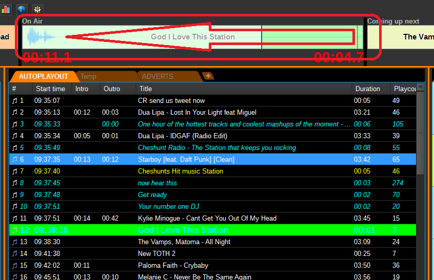

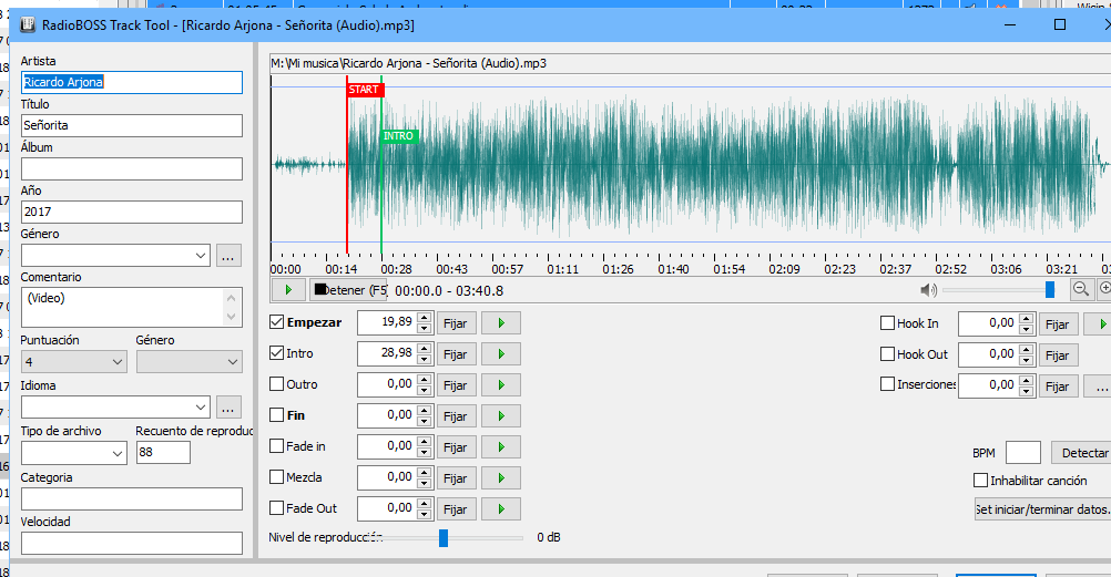

Another example of the problem with Intro
Establish a starting point must be the cause of the slipping
It appears that the cause was found :) Should be fixed in the next update

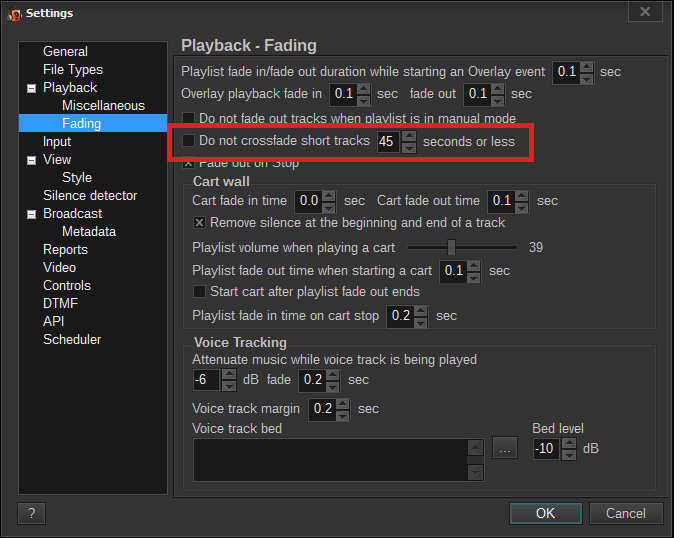

Also, Just an observation, I am able to set a mix point for Jingle File Types but it seems to be ignored.  My jingles have fade outs and regardless of placing a Mix Marker, there seems to be no effect and the Jingle plays to the End Marker.

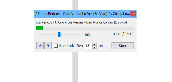

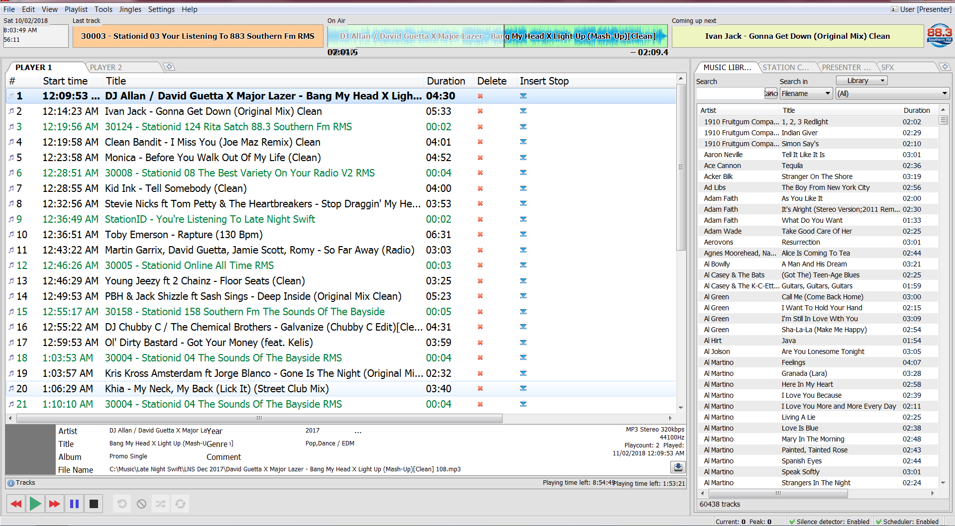

Upgraded to latest beta.
- Clock doesn't work
- Visual elements of the program are showing - e.g. labels are showing up as rectangles over other elements
- The countdown clock for the 'current' track is moving but seems to be overlapping itself
- Playing time left seems to appear twice
Something that was occurring previously but I hadn't reported yet, was the 'X' on the library shows words behind it, looks like 'Cancel'. Carts appear normal. All menus appear normal.
This is only happening on one system. The other two are unaffected.
I'm guessing this is graphics card related. Is there anything in particular we need to have loaded on our system in order for RadioBOSS to appear correctly? E.g. any DirectX or other graphics related codecs etc. we need to have installed?
I downgraded to 5.7.0.4 on the affected system and everything appears correctly again, other than the 'Cancel' word appearing behind the "X". I have "Intel HD Graphics 4400" installed as the graphics driver.
It appears that you have "Screen reader" mode enabled. Disabled it from the menu: View->Accessibility (Screen Reader) - make sure that's unchecked.
Please post a screenshot of jingle crossade settings, we'll try to reproduce it here.

I unchecked Settings>Playback > Fading> Do not crossfade Short Tracks which seemed to resolve my "issue". The Mix Marker appears on the Track Title Bar and the Jingle performs as expected
Thank you for pointing me in the right direction.
100% was that. Upgraded to newest beta and working as expected. Thank you.
P.S. Any possibility of adding ability to turn screen reader on/off in user access controls (e.g. admin can block)?
