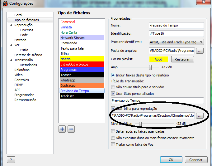

Hi Dmitry, I would like to suggest that in file types it is also possible to add lists and folders. This is handy so you do not have to keep changing the tracks manually so you would have a choice of random tracks.
Yes, this will be added in one of the next updates, thank you for the suggestion!
