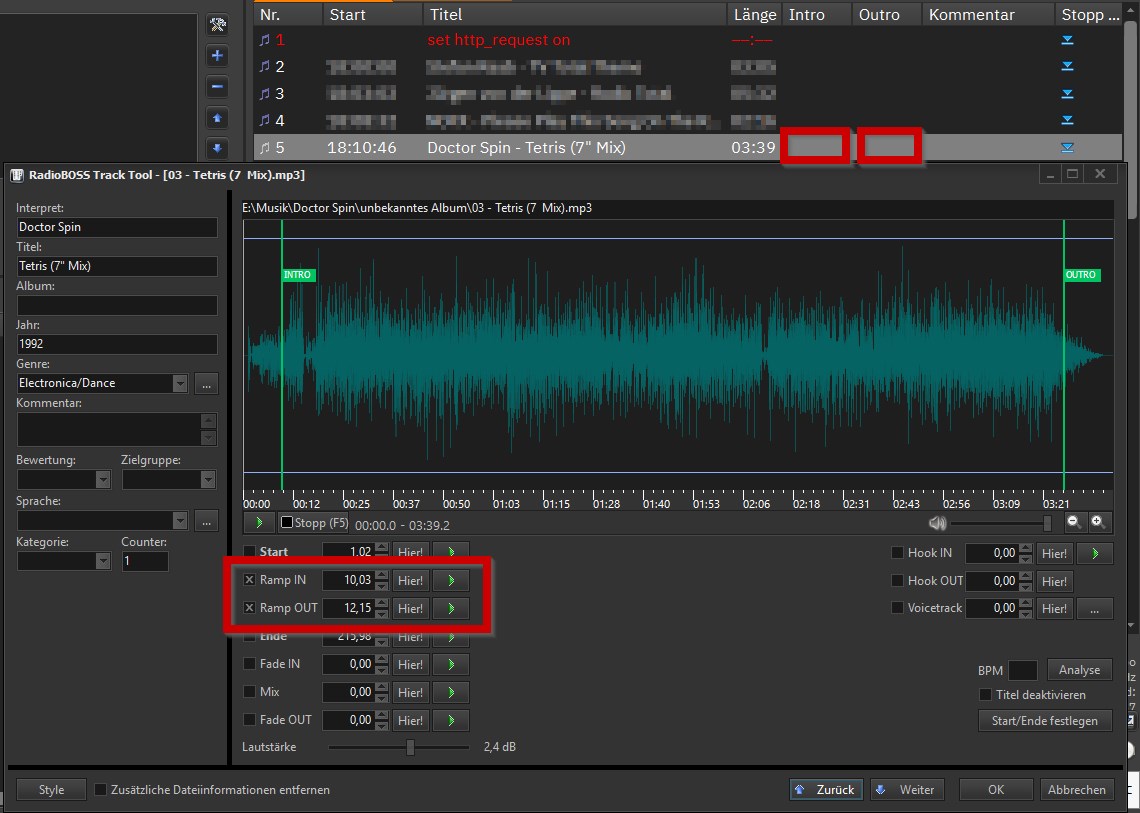

After setting Intro/Outro (Ramp IN/Ramp OUT) the playlist doesn't display that, like you see on the screenshot attached.
Have to restart RadioBOSS evertime to see changes, or delete the song and add it new to the playlist. (Since Beta. Think this is because the way the TT works now.)

Quote from: Basti on 21-09-2018, 18:00:28
    When setting Hook in/out or other things it doesn't set where I click... approx 1 second later
When you set the cursor somewhere, it shows you the current position. When you click the Set button for Hook In/Hook Out it will set this position for this point. It appears to work correctly here.

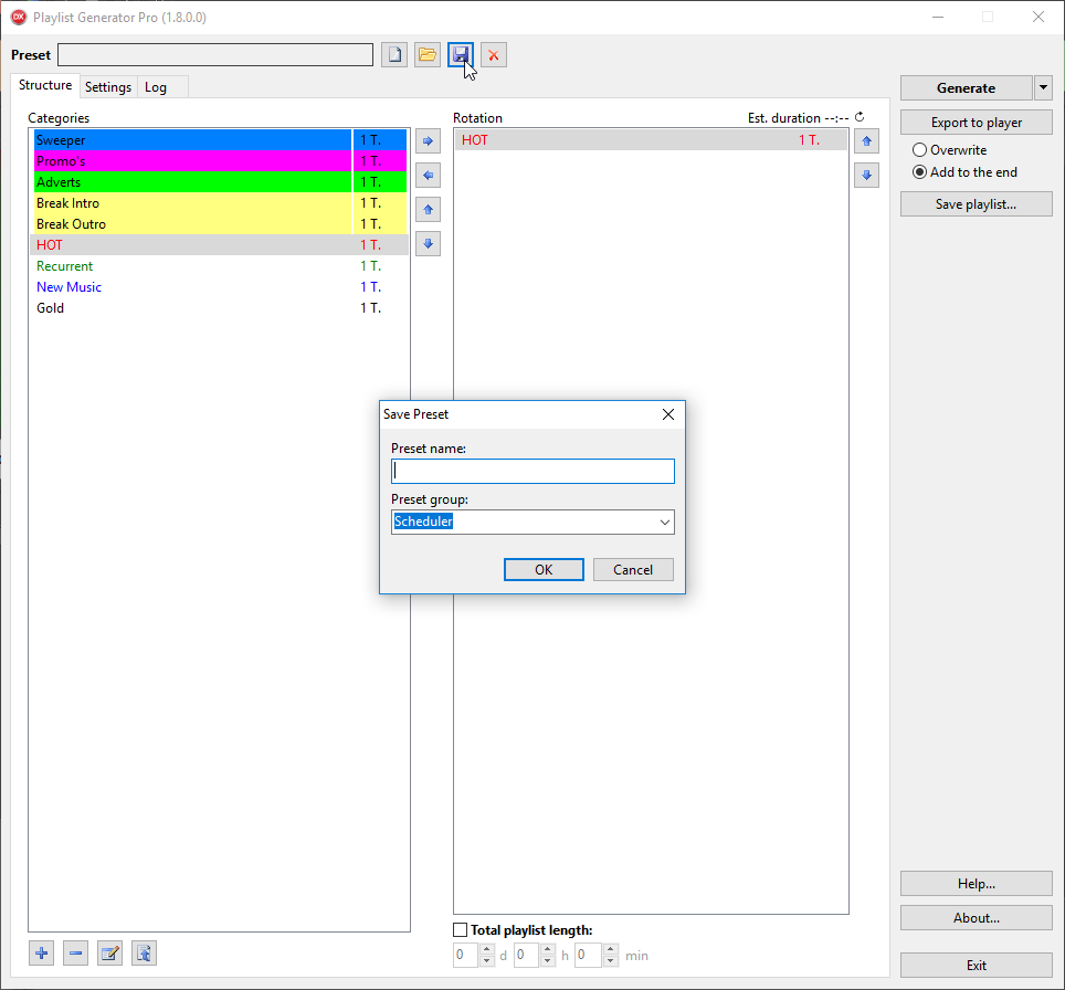

When saving a preset in the Playlist Generator, the Preset Group text is selected (if you have something at least in there). It looks a bit strange and doesn't make sense to have it selected.
Did you use the Next/Prev buttons to switch to the other tracks?
New update on this: You're right. When I stop at the point I want to set a point it's correctly.
But: Since I use RadioBOSS I've never stopped the playback in TrackTool to set an exactly point. Work finde before - but now....... not even more. That's really (!) bad, because not comfortable anymore.
If I remember correctly, nothing was changes and this is how Track Tool had always worked. Can you please provide the steps top reproduce the issue?
Thank you - we'll check if it's a bug.
Yes, I did.
I will try to record a video while doing this - so that you can see it exactly as possible. You'll get a link within the next days. :)
