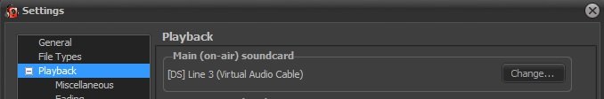

MAJOR PROBLEM that urgently needs fixing.
with PlayBack "Main On-air Sound Card"
If you were just using "Speakers Out" for your audio, you wouldn't be aware anything was wrong.
But I am using Virtual Audio Cable for sound output.
This first occurred with 5.8.0.3 but after switching sound cards around (about 4 times) and restarting RB and rebooting the computer also, it seemed to come right.
BUT in 5.8.0.4 I cannot rectify it.
Both my computers with RB are doing the same thing.
One computer is completely silent and only uses Virtual Audio Card for its output (tried VB-Audio, but the problem is no different).
The problem is this....Output should only be outputting on VAC Line 3, BUT the same sound is also coming thru on the Speakers (that is BOTH VAC Line 3 and the Speakers at the same time), but to make matters worse its NOT only outputting on the Speakers when it shouldn't be, but is outputting a distorted twin sound, an echoed/delayed output (possibly Speakers and a delayed output via VAC Line 3 causing the echo).
The sound output on VAC Line 3 is exactly as it should be. No distortion delay/echo like the Speakers. And thus VAC line 3 is perfectly usable.
On the silent computer this isn't a problem as there are no speakers plugged in. Its only outputting sound on VAC Line 4, and feeding that output direct into Shoutcast. Bear in mind the problem is most definitely there however should I plug the Speakers in, which should not have any sound coming out of them at all since its on VAC Line 4 for output.
The second computer output is VAC Line 3, but I cannot turn off the Speakers output, and I need the Speakers for other use. As a result I have had to turn RB off on this computer and use a temporary player in lieu.
On both occasions, with 5.8.0.3 and 5.8.0.4 this problem occurred immediately after the upgrade/s.
BTW, both computers are running Windows 7.

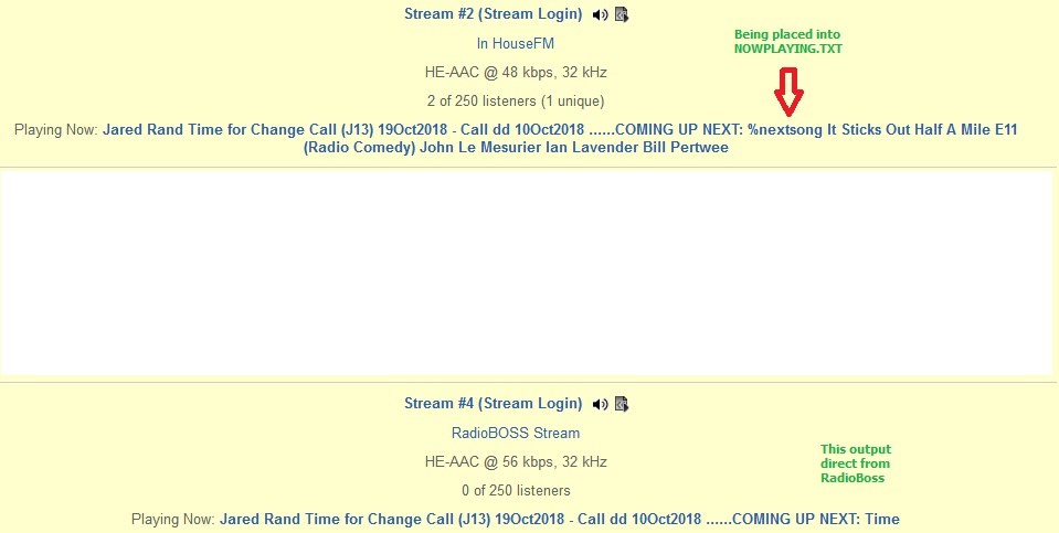

? %nextsong variable added for broadcasting title and HTTP request (next song title)
? Scheduler command to reset "played" track state in playlist (resetplayedstate)
Thank you. Both of these are working perfectly.

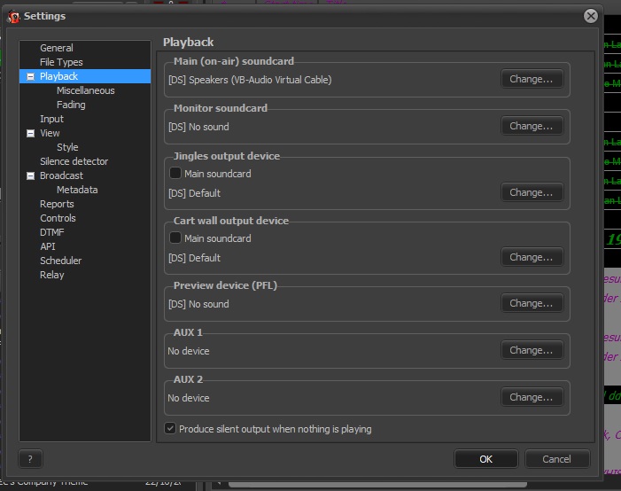

Please make sure that you don't use the "Monitor sound card" that outputs to the same device. It is usually the cause for the echo.
I also suggest to check the VAC settings, e.g. if it's configured to output the sound somewhere.

But no matter. I have gone back thru all of them. It turns out there is actually a "coincidence involved here" in regard to installs 3 and 4, as I have now discovered the problem started with 1 (and continued onwards).
I went right back to Ver 5.8.0.0. and when I got back to this version, everything worked just as it should.
The only slight hitch was the main sound card initially was "default" on installing 0, but once I resolved that to VAC Line 3, all was good. There was absolutely no longer any sound issues occurring with the Speakers.
When I install anything after that version the very same sound problems occur.
As a double check after using Ver 5.8.0.0, I reinstalled Ver 5.8.0.1 for a second time, and that is most definitely where the problems begin.
So its Version 5.8.0.1, 2, 3 and 4 that all have this very same condition.
Just why it wasn't occurring when I initially installed 1 and 2, I do not know. For me it only started in 3 (which I somehow resolved) and appeared again majorly without being able to resolve it, in 4.
PS
The clue to this problem appears to be tied in somehow with the Default Sound output.
Change the default sound output and RB follows it.
PPS
WOW..... I have had success. I worked it out, has only taken me a days total of work, but finally got there.
djsoft, this is what you have to fix :
I had the key to fixing it above all along, and just didn't realize I had already worked it out.
This is the workaround :
Change the RB Main Soundcard output to Default, then Save.
Open Options/Playback up again and then change the Main Soundcard output to the one you actually want to use (such as VAC Line 3) and then save again.
These actions stops all sound coming out of the speakers. Finally !!
This procedure worked on both Win computers running RB.
It must be that somehow that the bug is causing the phantom "VAC Line 3" and the phantom "Default Speakers Output" to be both directed towards  the speakers, hence the twin/echo sound.
However the VAC Line 3 (by itself)  is working exactly as it should with no problems in spite of this.
But the slight buffering delay of VAC Line 3 thru the Control Panel and onwards to the Speakers is what was causing the echo.

Yes, this can be reproduced here, thank you. It seems that the bug still can not be reproduced here. Can you please post the Playback settings window screenshot?

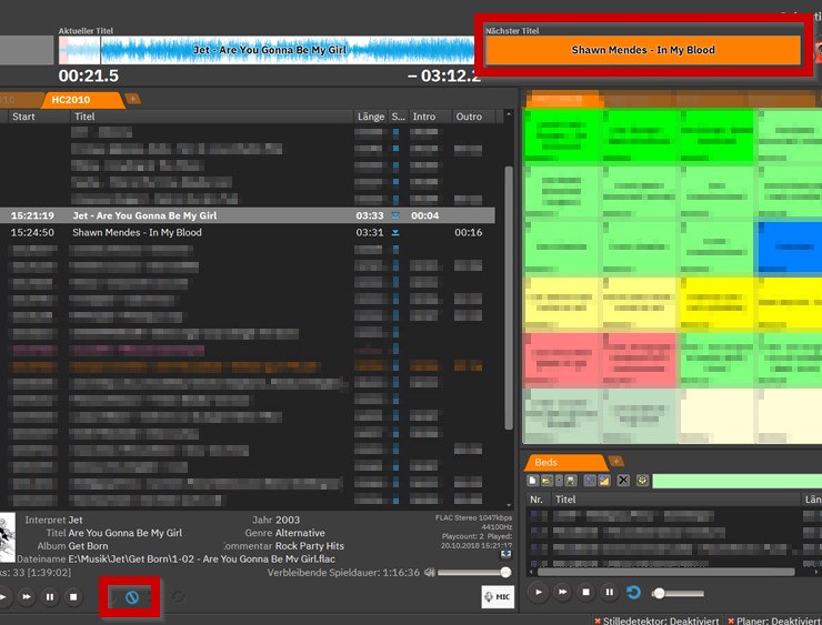

vk1337 // Basti said:
Still unfixed:
This turned out to be not that simple. According to the internal documentation, it intentionally shows the next track title - however, the docs do not say for what reason :) We'll leave it as it is for now.
Win 7 is the OS on both computers (1 Pro and the other Ultimate).
When I re-installed Ver 5.8.0.0. the only reason I suspect it worked immediately (in my testing) was because it installed with the Main SoundCard as Default, which I changed to (in this case VAC Line 3) and I did not have the speakers problem.
Each install after that in testing (that is, 1 thru 4) picked up the previous setting and had the very same speakers output problem.
For me the first instance of this problem happening originally was immediately after installing the beta update 5.8.0.3, but I solved it without being able to recollect some days later just how I achieved that when it came to installing the subsequent 5.8.0.4.
BUT in test mode, on re-installing 5.8.0.1 and 5.8.0.2 for the second time, the speakers problem was occurring in both 1 & 2 as well as 3 & 4.
BUT NOTE, this did not happen in the original installs of 1 & 2.
The question is why did things turn sour when I first installed Ver 3 and not earlier in 1 & 2 ?
You will see in the pic that all other sound outputs are turned off.
This is no different from when the problem was occurring, I had all settings off, with only the Main Soundcard operating, in trying to isolate the problem.

This problem only seemed to start after the installation of Ver 5.8.0.4
For some reason it started adding "%nextsong" into the nowplaying text.
The two outputs are coming from the same RadioBoss player.
No 2 stream NowPlaying text is via RadioCaster.
No 4 stream is direct from RB.
Also you will note the nowplaying.txt (stream 2) is actually showing the next track.
The one from RB direct is showing "an event" rather than the next track.
This event being in between the current track and the next track as I look right now.
Its also quite possible the event occurred after the nowplaying.txt file was written to, thus updating more regularly via RB is the the reason for it showing ??
The %nextsong tag should also work in nowplaying. I suppose the problem here is that you have installed an older version where this tag is not supported, that version created the nowplaying file with the tag instead of actual song name.
