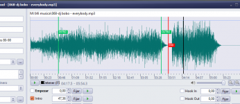

There are several problems in TrackTool.
I was testing Mark the intro on this track.
Sometimes the waveform does not match the beginning of the track. (The waveform was silent, but the reproduction was more advanced)
Steps to reproduce the problem:
-Click on the play button, move with the mouse the reproduction to the part that is attached in the image.
If you click several times, the reproduction starts from the correct part.
The pre-listening buttons for the points also have this problem
Song: http://appgim.eshost.com.ar/test.mp3
With the attached track, set the starting point at 0.90 and 0.70 and make a preview of both points.
It could be a bug, thanks for the information!
