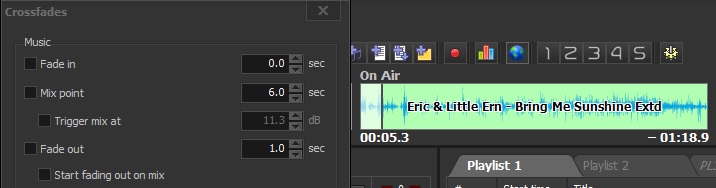

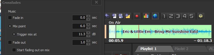

Bug in file type: changes are applied when editing. (If the edition is canceled the same change applies)
Yes, this is a known issue and the problem also exists with broadcasting encoders and some other settings too. I don't think this will be fixed, instead, the Cancel button may be removed from the settings, as it seems to be how most of the "settings" windows work nowadays (e.g. settings in Windows 10).

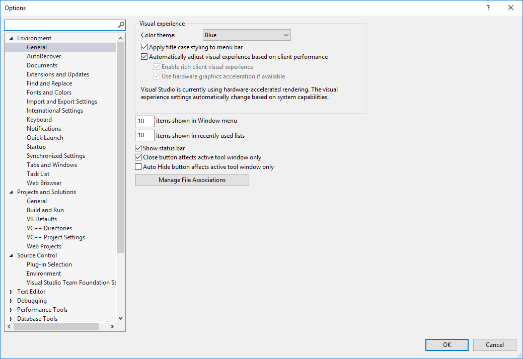

Yes, there are some settings that are accessed more frequently than others, but that also depends on the user's situation... RadioBOSS settings window is not really complicated, and it doesn't (yet) require complete overhaul (while some minor improvements could be made and anyone is welcome to suggest those). I suggest you to take a look at the options window from Visual Studio to compare (attached)
I am not familiar with Visual Studio, but you are absolutely right, its a shocker of a menu system. And certainly a good example of "how NOT to do it" !
But its not a matter of just saying how good yours is compared to them. You need to be saying to yourself "how can we bring an even better presentation to that which we presently provide".

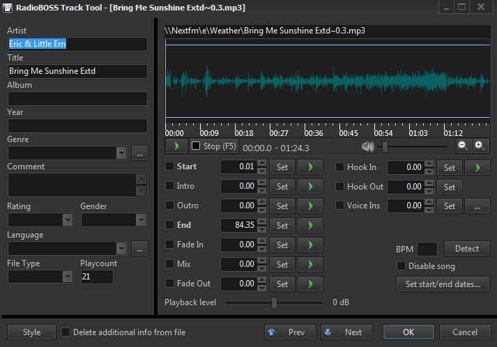

Maybe also work on Track Tool suggested here: https://www.djsoft.net/smf/index.php/topic,5601.msg27395.html#msg27395
These 2 small things would be a beginning to a good future, or so? :P

The file in the Track Tool pic below is 84.3 secs long.
The mix point in Crossfades is 6 secs long.
Its mixing at where the red line is, but not turning the usual blue colour to show a mix fade out point (or is that just caused by Track Tool ? I am pretty sure its at all mixing points).
I was initially blaming this problem on APEv2, but now I don't think it is since its continuing on on SQLite
When you look at the pic showing the picture playing there is a red line at circa 60 secs from the end. This isn't 6 seconds from the end, but almost at the opposite end, the start (but not 6 secs from the start).
Whether "Remove Gaps" is on or off doesn't seem to make any difference.
Take the Crossfades Mix out and you will see in the second picture, the track will play in full with NO red line anywhere in the track.
To make sure I have this right.
When you add in a mix point by itself, it mixes at that point. In this example it mixes at 6 seconds.
NOW if you add in "Trigger Mix at" it reads ahead from 6 seconds until the end (or end of actual sound), determines where the -11.3 db target is and mixes at that point.
"Trigger Mix at" does not work by itself when I read the Help file. Only in conjunction with the Mix Point.
If I have that right, and that is the way it is supposed to work, then something is wrong.
