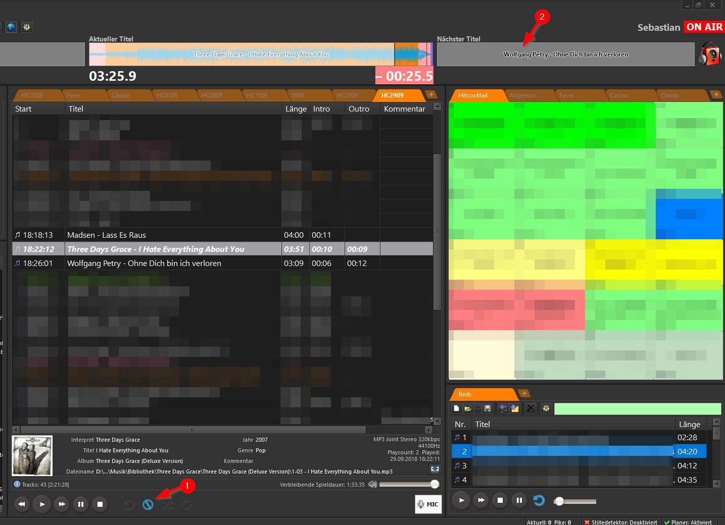

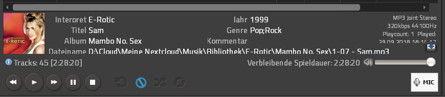

Even when I am have the "stop after current track" option enables, RB shows up the next track in the upper right corner. RB doesn't play it after end, but is showing the countdown for intro on current track section.

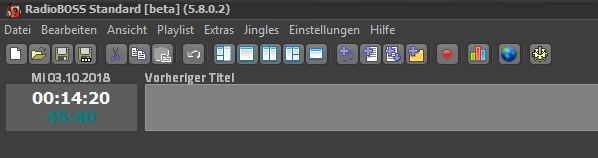

Another thing is, that title bar and menu bar hasn't the font selected for "main window"... it seems to be Tahoma?!Also track infos cut off, when font size is >10.

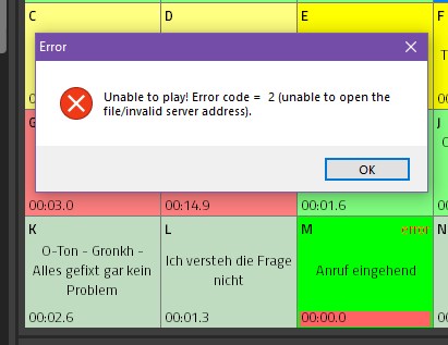

The "error" label on an invalid cartwall element should be shown at RadioBOSS startup. That prevents ugly error prompts. :)

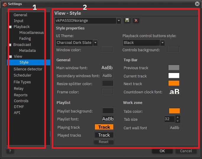

Why don't you order the settings tree more by relevance (1) or rearrange the style properties (2), that it makes more sense? =)

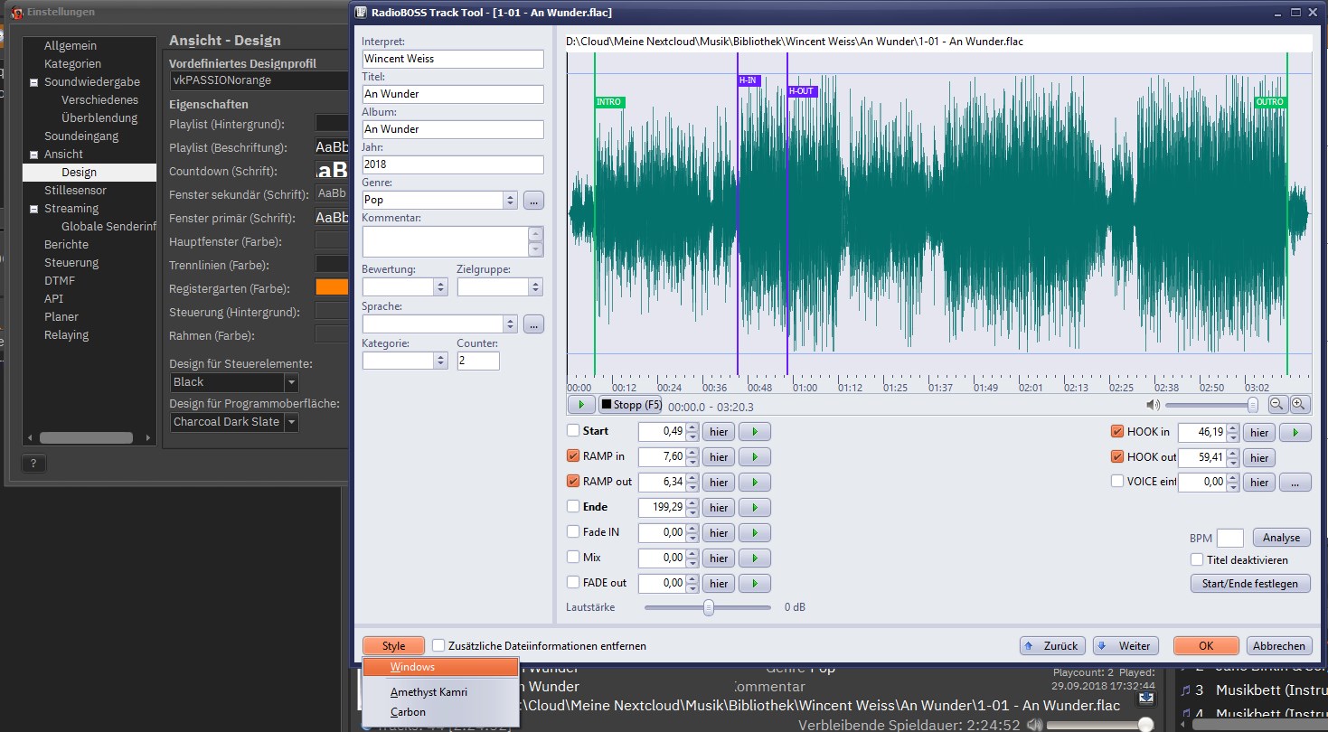

I wondering about, that I am not able to choose "Charcoal Dark Slate" for Track Tool, and "Amethyst Kamri" not for main window.
Woulnd't it be better to move the "Amethyst Kamri" to general RadioBOSS Settings, apply UI design to TrackTool / Music libary and delete the "style button" in track tool?
And why does Track Tool using another font family?

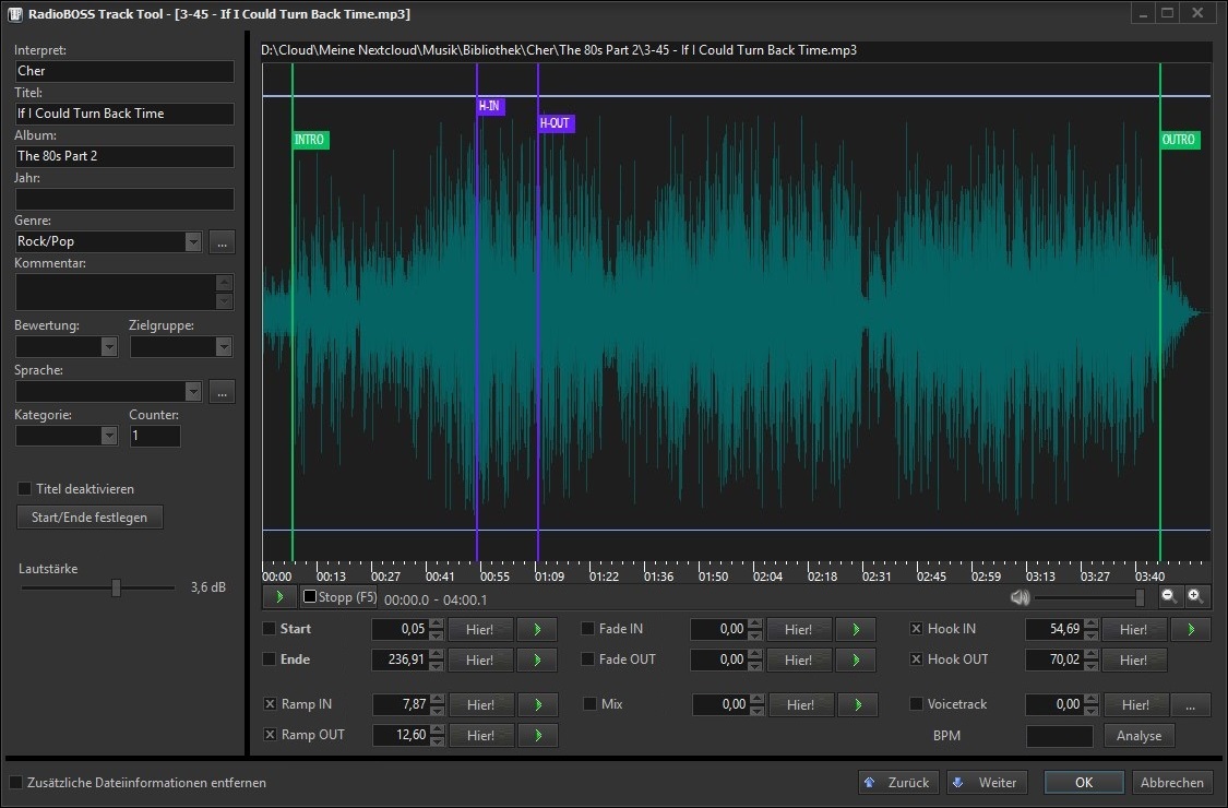

In addition to my post before I made some minds about the track tool.The arrangement of the items at this point is a bit narrowly and confusing.
That's why I have some improvements.
General:
  • Moving "volume" to left sidebar- Moving "start and end date"  to left sidebar
  • Moving "deactivate title" to left sidebar
  • Remove "style" Button due to my last posting (apply style from global RB settings)
  • Increase width of labels for Marker fields a bit
  • Increase width of "set" buttons a bit
  • Decrease height of markers area- Increase height of wave form (or decrease height of Track Tool to save space at all)
Row 1:
  • Column 1:
  • Marker for "start" and "end" points among themselves
  • Column 2:
  • Marker for "Fade in" and "Fade out" points among themselves
  • Column 3:
  • Marker for "Hook in" and "Hook out" points among themselves
Row 2:
  • Column 1:
  • Marker for "Intro" and "Outro" points among themselves (called "Ramp" in Germany)
  • Column 2:
  • Marker for "Mix" point
  • Column 3:
  • Marker for "Voicetrack insert" and BPM analysis among themselves
Finally that cleans up the Track Tool a bit, and the new arrangement would make more sense (because it's "logic").What do you think about that? =)
I like your suggested improvements Basti.  :)
Some good ideas there. And you have done some excellent work in the graphics too, which look really good.
Yes, it should be empty - will be fixed.
The track info tab will resize to fit the large font. As for title and menu fonts, there are technical reasons for those to stay at default fonts (custom fonts doesn't work properly).
That looks better, no doubt. But the problem here is that the software exists for some time (15+ years), and people have habits. Rearranging the settings will require re-learning and searching for things that are now moved to different places. This can be annoying so we delay major UI changes as long as possible :)
Track Tool has its own styling options, and currently it uses the default system font for its window (the font setting is actually only available in RadioBOSS as it's the windows that is on the screen most of the time). The thing with TT is that the song waveform and other controls there doesn't look good with many styles, so the style set is limited.
The styles are different on purpose, some users have different styles for Track Tool, Ads Scheduler to easily distinguish between windows.
This looks interesting and thanks for the demo window. Please note that there could be up to 5 more user defined fields on the left and this will make window tall. The window as it is now indeed has lots of controls and it requires deeper changes, like going away from concept of "[ ] Name N.NN Set Play" for markers to something else...
