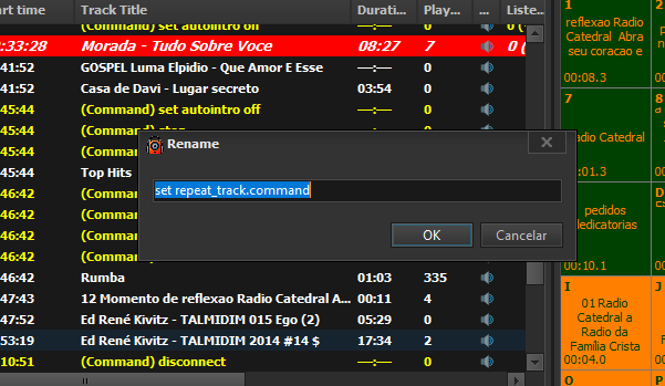

Esta dando erro em comandos quando inseridos na playlist. Apesar de aceitar o comando, a playlist congela e nao pula a faixa.
Segue abaixo mensagens de erro no log
Command: set autointro off
Unable to play! Error code 2 (unable to open the file/invalid server address).
If you add commands to the playlist, use the Playlist->Add command feature, and if you modify playlist manually using text editor, include .command after the actual command, e.g. set autointro off.command
You can reset the playcount: https://www.djsoft.net/community/threads/reset-playcount-in-radioboss.6299/ and an option to also clear Last Played will be added too in the future versions. The played history column will be added to the music library.
Thank you, it looks like track metadata is indeed wrong.
Currently it's a limitation, only one track can be dragged. If you need to move multiple tracks it could be better to use Cut/Paste features.
É exatamente assim que estou fazendo, como pode ver nos prints.
O comando "set autointro off" ele é obedecido, porem aparece o erro "Unable to play! Error code 2 (unable to open the file/invalid server address)." no log.
O comando "set repeat_track" além de não ser obedecido, ele trava a playlist. esta funcionando como se fosse um "stop".
O comando "stop" nao funciona na playlist auxiliar, nao importando a maneira usada para coloca-lo.
In the 6.0.0.5 update, the error in the "set autointro off / on" command was solved.
The "stop" command error in the auxiliary playlist persists.
The error of the command "set repeat_track" continues and now it is running infinitely, as you can see in the log.

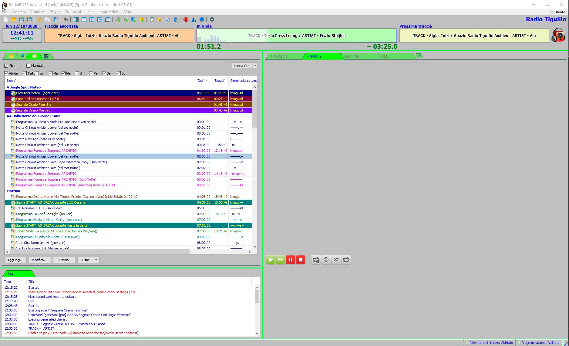

Ciao,
Ecco cosa vedo nella schermata principale.
Il programma con la mia configurazione del colore impostata.
Non riesco più a vedere il giocatore.
E tutto un'immagine grigia.
Thank you, we'll see what could be wrong there.
