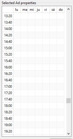

A small bug in Ads scheduler. In the 'Settings' tab, the 'Profile name for reports' remains on all other tabs.

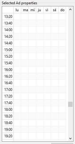

It might be a good idea if the days always remained visible when I scroll through the Ads block, so that I don't have to think about which column corresponds to which day. Currently, they disappear when I scroll down.
We have reset RB and now the days in the Ads block are visible even when scrolling. So please disregard my previous post. Everything is OK.
