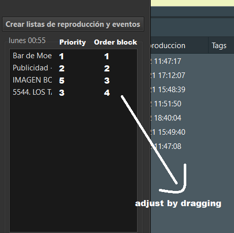

This was requested couple of times, but the problem here is any custom ordering can't be automated. If you arrange some ads manually, it prevents ads scheduler from creating the blocks in fully automatic mode. What happens with the order when some ads are expired, new ads added? What if more than 9 priorities are added, what do you think?
The problem with a global priority is that it will cause all the blocks to have the same priorities.
The same commercial that in a block is the first, could be the last in another.
With this approach it is not possible.
In addition to the commercial priority, we could think of a commercial priority per block. (By default at 5 and it is adjusted by moving the ads)
Something like this
It's not a brilliant idea, but it's what I can think of at the moment.
Another solution is to migrate priorities to the order of this list, but the option of a global setting for all blocks is lost.
It would be better if one of these two options could be activated simply with the arrow up, down or left and right. But when he can't do it like that, it's good that he can do it like this.
We won't be fixing it because we will be redesigning Event window completely in the next update - and the issue with radiobuttons will no longer present there.
Something like this
Having fixed positions will not work, because new ads can be added, removed, some ads will expire or start based on dates. One possibility is to add something like "Block priority" that will override the global Ad priority for this specific block, what do you think?
It's exactly my idea :)

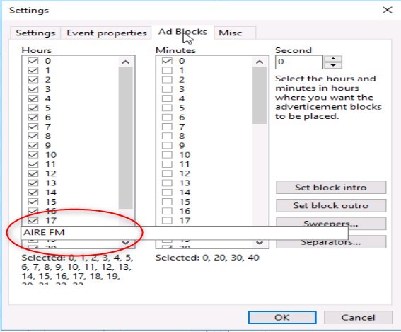

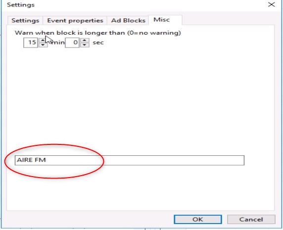

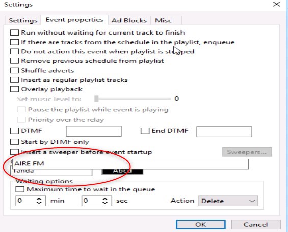

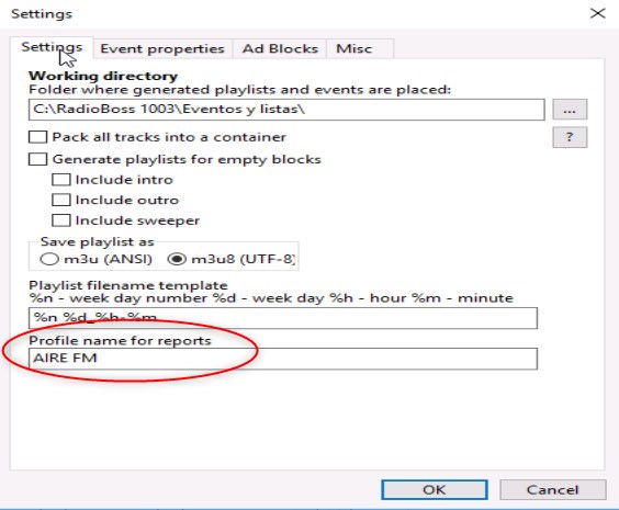

Just a little bug,
when you browse the settings tabs, the "profile name for reports" always appears.

Just a little bug,
Thank you!
