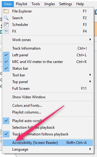

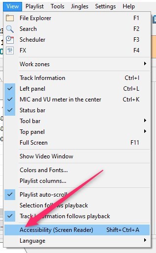

Hello! I discovered some graphical errors. In some places, the inscriptions slide onto the buttons. My screen resolution is 1920x1080. Due to my vision, the DPI is 150%. RadioBoss Version 6.3.0.1 Here are some pictures showing where I found these bugs. I hope that I can help you with your work.
This is not a bug. When you enable "Screen reader" mode, it adds captions for the buttons, so that screen reader software can read those buttons. Without this option, buttons do not have captions, only icon.
