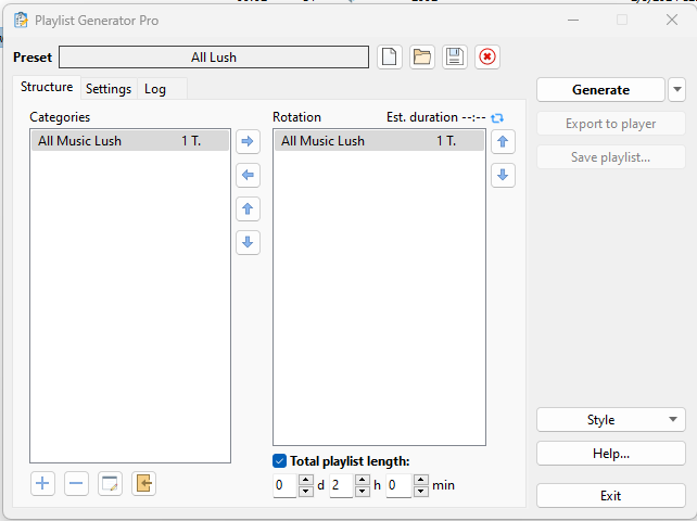

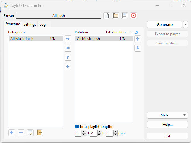

HI Tried this and all was ok
Generation started.
Loading category "All Music Lush"
Category "All Music Lush": loaded 1992 tracks
Tracks after filters applied: 1992
Creating playlist...
Time spent: 00:02
Completed. Playlist duration: 2:00:40
Did you set minutes in first screen? Its where I went wrong first time Hope it works for you otherwise your playlist may not have enough music.
You may also have given a prescriptive filter which does not allow enough tracks. But this is not the case I see as you have 680.

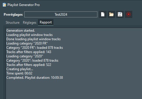

Thank you for your message.
Yes, I set the desired time on the first screen you mentioned.
I also have enough titles for this test (143 and 522 selected). See screenshot.

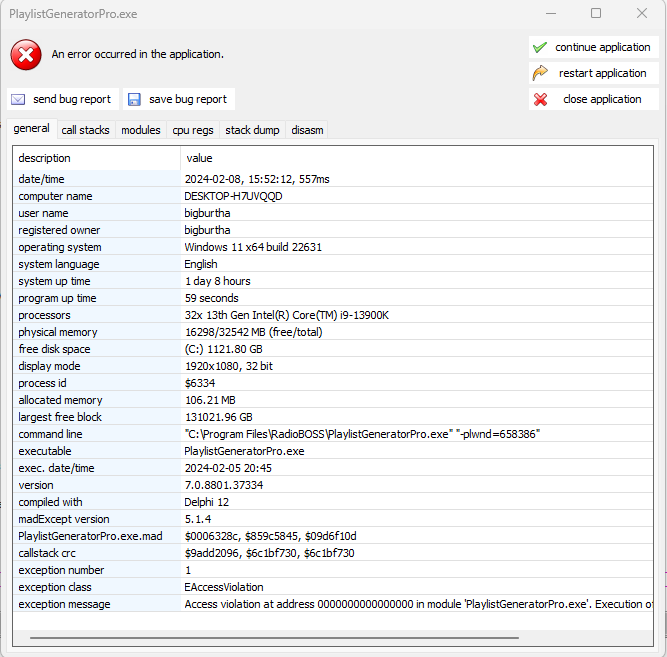

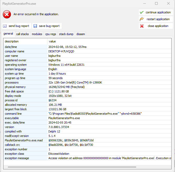

I've been investigating this peculiar bug. The playlists are created by the Playlist Generator. That line is always at the last position. Even though the same playlist is run, this line sometimes appears, and sometimes it doesn't. This line is completely empty, it doesn't even show the name or its path in the File name. However, when I open it in Track Tools, it shows that it's a prf file in the Profile folder.
In the Playlist Generator, when I create Export to playlist for some of the Presets, this empty line also sometimes appears (always at the last position).
One more thing, when I run Generate consecutively 2-3 times in the Playlist Generator, I get an Access violation window. I've sent you the playlist and this bug report via email.
Indeed, I have the same problem (7.0.1.4 Beta)
I also get this error sometimes.
