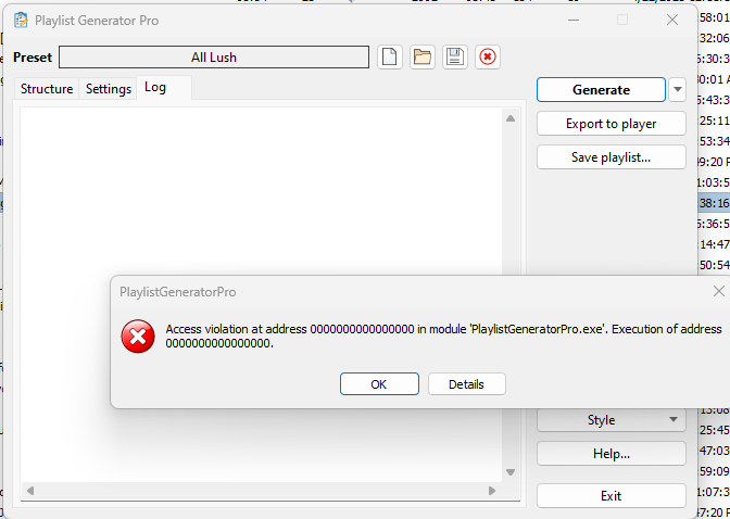

I also got an error message when clicking exit. This same error message appeared when I clicked "Generate" (RadioBOSS 7.0.1.4)
Yes, thank you, this will be fixed in the next update.

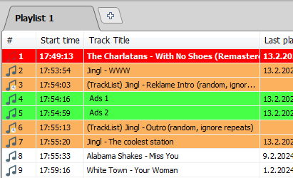

I think the issue with 'Fixed a bug when skipped tracks were not removed with Queue option on' hasn't been fully resolved. Yes, when there are two, for example, Jingles played consecutively, the unplayed Jingle is removed from the playlist. In our setup, after an Ads block, an Outro Jingle is played, and if there's another Jingle after that Outro, even if it hasn't been played, it remains in the playlist. The Intro and Outro Ads Jingles are tagged as Jingles in the File Types Identifiers (just like other Jingles).
Interestingly, if a Jingle comes before the Intro Ads Jingle, both are removed from the playlist, but the Jingle after the Outro remains.
You can see it in the screenshot. Tomorrow I'll do some more testing to figure out what's going on.
In RB 6 with the same settings, everything worked as it should.
