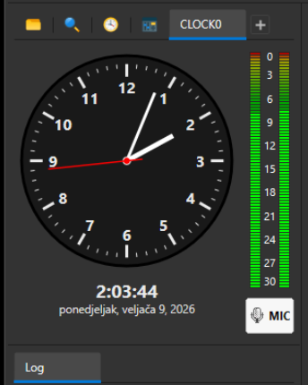

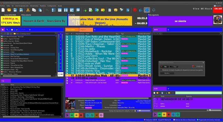

I checked the box, but the clock is still in 12-hour format. It would be helpful to be able to change the date format.
I can confirm the problem (the afternoon has just begun as I write this).
Furthermore, when the time is adjusted in the display settings (view), the change is not applied. However, it is correctly applied in the window next to "On Air".
Regards
True, same thing here.

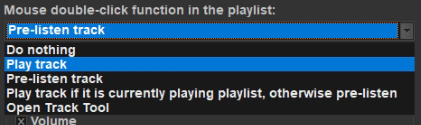

They can add the option “mark as next” on double-click. (Only mark as next, without adding it to the queue.)
The playback queue if, effectively, a "mark as next" feature.
The “Add to queue” function is not the same as “Mark as next”.
The queue creates an additional list with one or more tracks and requires management, which becomes tedious when you want to quickly change the next track.
“Mark as next” would be a one-time action: the selected track plays immediately after the current one, then playback continues normally without creating or modifying any queue.
