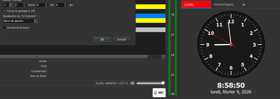

Clock uses the system time format. 24-hour clock can be enabled from Settings > View.
I checked the box, but the clock is still in 12-hour format. It would be helpful to be able to change the date format.
Your screenshot shows the time as of this Monday morning, and you posted it this Monday morning. I don't think it's not working… We'd have to wait until 1 PM to be sure ;) And I think that if the 12-hour clock system is set (depending on your PC's configuration), an "AM" or "PM" indication would appear next to the time.
My PC clock is in a 24hour format. Radioboss playlist shows in 24 hours format. It's only the clock that remains in 12hour clock format... Even after forcing the 24 hour setting.
I can confirm the problem (the afternoon has just begun as I write this).
Furthermore, when the time is adjusted in the display settings (view), the change is not applied. However, it is correctly applied in the window next to "On Air".
Probably a bug, we'll check it.
Thank you, this will be fixed.
