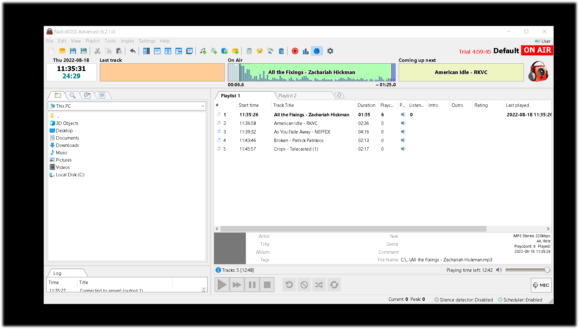

Before exit RDP

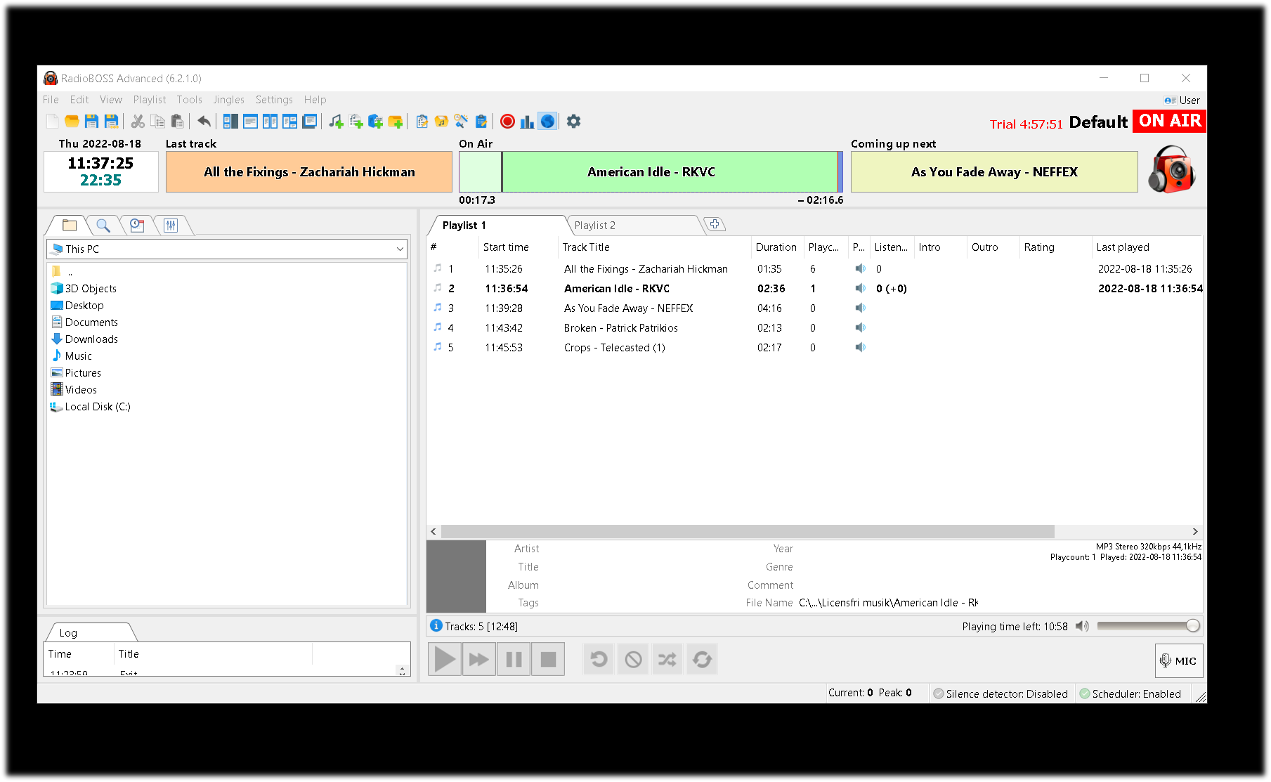

After exit RDP
Looks like it's a problem with audio device. If you don't need it to play on an actual device - select "No sound" option for the the Main Soundcard in Playback settings.
Thanks for the answer (to be honest i'm not sure if I do understand what you meen so please, can you be a bit more specific :-)
We do like the software to play and stream, the issue is still when disconnect from Windows RDP everthing stop.
If using Chrome Remote Desktop it works without changing anything as you suggest above however using Windows RDP the player stops. We are trying to find out why this is happening :-)

Before exit RDP
After exit RDP
