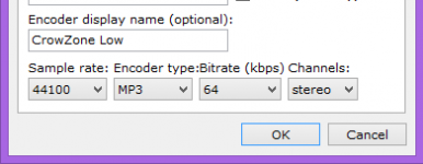

I am trying to set up a low bandwidth mount for a mobile phone app which seems to struggle at 128K, so I have created a new mountpoint on the stream (/low) with it's own 64K Auto/DJ. I can connect to that fine with radioBoss, until I try to connect to the 128 mountpoint at the same time (/live).
I can't see why it should not work, we have good internet so it should handle the upload speed, and each mount works individually, just not together.
Is this expected?
Anticipating the first question, I think I have the second mountpoint set up properly at 64K:
